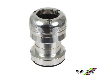

Your only option is an American Classic Trilock Headset…
…and it just so happens I have one I’m willing to part with.
Have read elsewhere that those can be a bit shit. Apparently American Classic stopped manufacturing them and recommend replacing with Chris King or Cane Creek lol.
^ Mine was fine while it was installed. Their biggest problem is they look like shit.
