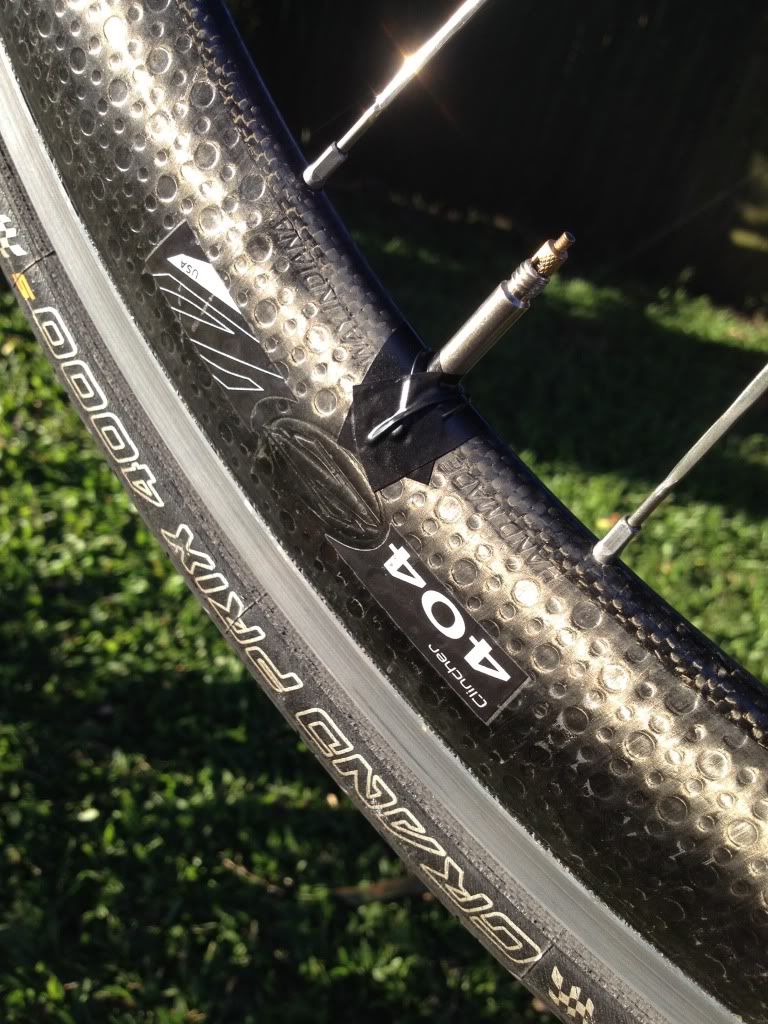

Got sick of the valve stems rattling like crazy (and spooking the shit outta me cause it sounds like all the spokes are about to let go) whilst in fast descending corners. So came up with this for the hills tomorrow…. #proasmate
^ i found blu-tack shoved around the valve helped on my cosmic SLs
I got some electrical tape and wrapped it back on itself around a valve stem. That way it keeps the right size and shape and you can just slide it over the valve stem once you’ve put the tyre on.
And it doesn’t look ugly like ^that^ :wink:
drinking straws. (sometimes)
Oh man so f’ing ugly not to mention not aero!! Didn’t think of the reverse wrap, will do…. tomorrow…… maybe.
Tape works perfectly but if you want the clean pro look, grab one of those round clear thin (apparently) self adhesive patches - prick a hole in the centre and slip it on over the valve.
I use em on the frame too in the spots that cables contact
fucking clever, rubber o rings might go alright here too
Dreaming dickhead - durex/ansells are way too big for that
too tight to shell out for a new thingy for my beat up old sidi’s
^^ Thread win.
I use some of the PRO bartape adhesive strips. If you cut it you get three PRO’s worth per valve. By default it is the most pro setup you can have.
Alternatively, a kanye’s skunkworks sticker works excellent too.
this is the go
unfortunately i have some rattling on a track tubular and i dont really fancy removing the tyre to fix it so i have the ugly external tape happening… if you have to do this make sure you use proper duct tape because the electrical tape doesnt hold all that well and just ends up coming off

A short piece of heatshrink from your local electrical store works well, have done this in Shamal’s, Tecno416’s and other deep alloy rims, heat gun and carbon rim may be less than ideal though.
what happend to those two little gromment things I gave you, did they work, I can’t remember.
No they didn’t fit. I can’t really remember either :slight_smile:
I think they were for putting presta valves in schraeder holes maybe.
what about using heat shrink?
