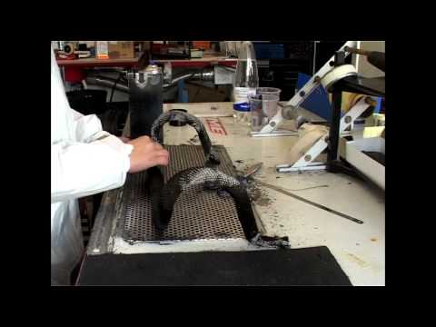

How carbon fork manufacture scares me…but I never ride Fill Carbon bike before.
