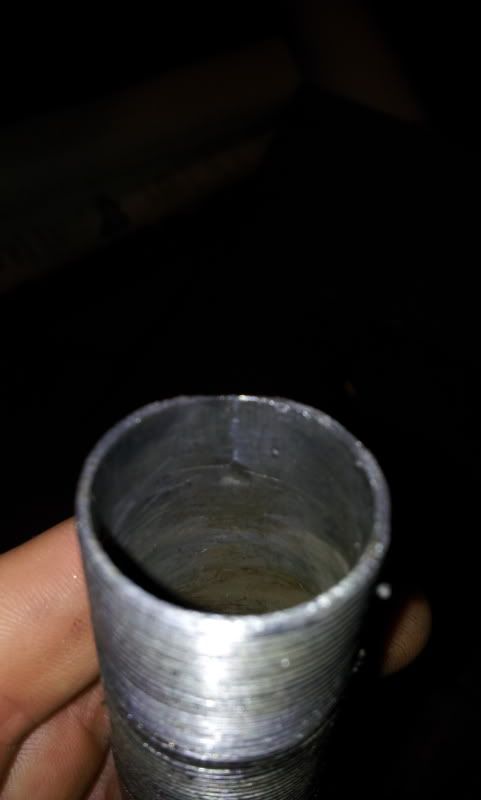

crack in steerer tube
it had a small almost invisible vertical 10mm~ crack in it when i bought the frame about 3 years ago, haven’t pulled the fork since then. had a check on it tonight, and it’s worse then i was expecting. it looks as if the insertion point of the stem pressed against the crack and split it horizontally as well.
do i have any reasonable priced options to repair it? i thought i could get it welded up and bored out, but the steerer has been shaved/flattened on the back section and there isn’t really any material to repair. i think i may be able to get a new steerer pressed in? it’s on the 1970 RIH so i want to keep it pretty stock for visual appeal (no new fork)

I don’t think that your quill stem should affect the crack - by the image (i’m not sure of the proportions) it looks as though its quite high up on the fork. You’ll find that the headset will make its way down and most of the force is taken by the threads downwards.
So long as your stem is at least inserted at its minimum point and you have all the right headset gear to close the threads up top, I don’t see a problem.
If you want have piece of mind, you have get a frame builder to replace the steer - i’m not sure where in melbourne. Sydney I’d go to the Bundy’s
on second thought - your stem may have a bit of play. That section has been shaved off because traditionally there is a washer with a flat surface the goes between headset lock rings to stop them from spinning. If your stem has play it will naturally press against this point and cause it to crack. - thats my 2 cents.

Sorry, but your 2c are wrong.
The headset applies a compressive force to the bearings/cups/head tube by applying a tensile force to the steerer tube.
The filed flat on the back of the steerer, plus the stress concentration at the base of the cut threads, plus the existing flaw = tensile failure and crack growth.

The crack will continue to grow, assisted by the tensile force from the headset and forces from riding. It will eventually grow around the circumference until it fractures from tensile overload.

i dropped the fork off with kevin at paconi today, he seemed confident that brazing up the crack and recutting the threads would be fine, he won’t recut the keyway, so the added filler should add some strength to that part of the fork that was previously missing. he said he doesn’t cut and weld steerers anymore, i assume due to the possibility of terminal failure, and that even replacing the whole steerer ran the risk of cracking the fork crown occasionally, especially with drilled track and road forks. should be around $80. i will post a picture when i get it back for the foa databank.
