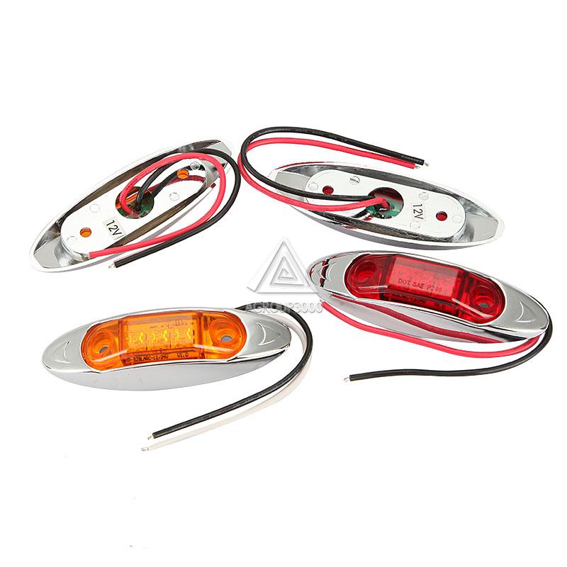

10x these. I like how they are amber on the front and red on the rear.

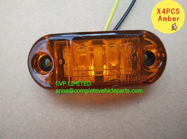

Naaw these
Or these
Designed for 12v systems but may well light up acceptably well at 6v. If not, get a DC to DC converter (or replace the dropper resistor with the correct one for 6v). Don’t wire them in series.
Yeah cool. Thought the dyno would be up to it. I’ll see if I can source some 6v jobbies, otherwise go the 12v conversion with some of those amber ones.
Thanks
If you go with bare leds you can (will have to) hook up resistors to suit your drive voltage, but getting a prefabbed housing, lens and led makes life a lot easier. One DC to DC step up transformer for the lot would be an easy solution, but do try running them off 6v to start with, you could well get lucky. The only 6v ones in housings you’ll likely find are motorbike indicators so the form factor will be no good.
