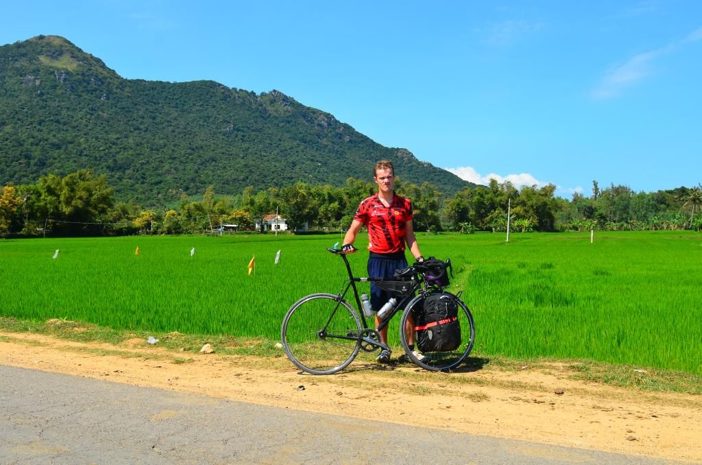

How good are you with a rattle can? I used a nitto m18 with the supplied p-clamps and it was pretty sweet. It had an SLR/Feck off Lens/ipad/ipod/language book/sunscreen on it all the time and at one point it had a piss off tripod strapped to it. the only problem for you is that it’s silver.
If you want tougher mounting, Tooobus make these in lieu of P-clamp type things. depending on the shape of your fork they can be fekin good.

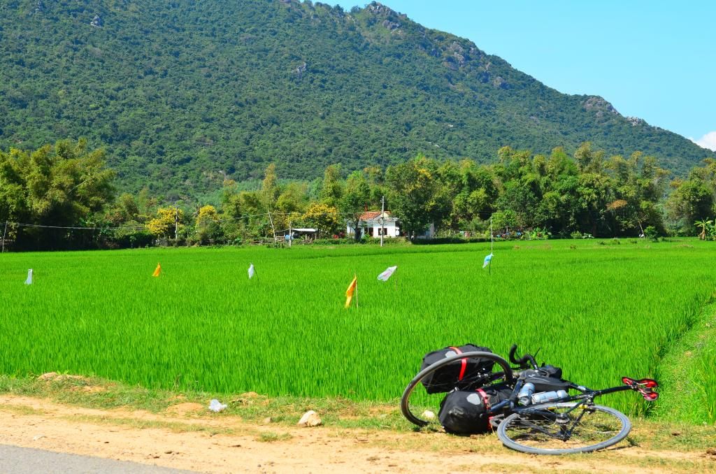

I did shit like this with no problem:

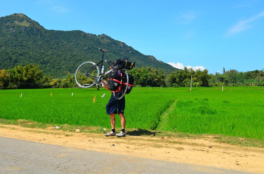

These next two photos are to demonstrate how heavy the bike was. I spent like half an hour trying to get a photo of it loaded above my head(so many weird looks from motos). couldn’t, partly due to dead left hand, but still yeah, rode the crap out of it over shit shit roads with lots of weight and nothing ever slipped or broke or blah.
Did you ride with a skirt? Still impressed by your set up!!! Its a Cross Check and thanks for the input.
