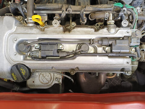

It drives well, is quiet and comfortable and only uses about 1.5ltr/100km more than the Swift, that is comparitively noisy and less comfortable on our crappy roads. The Swift is 20 years old now and has had a few issues lately. Ignition coils and front suspension strut mounts flogged out. All fixed myself but the Tucson is just nicer to drive and no reliability problems I am aware of.

With the ignition coil failing issue. Have you still got the engine covers on? If so, get rid of them. They’re just asthetics and generally increase the ignition coil temperatures. It was the first thing I did when I got the Corolla. 22 years old now and no coil problems yet.

There is a plastic cover that sits over them but leaving it there. Don’t think it will make much difference and easy to replace. Not expensive. Just intermittent missing below 2k rpm. Fine above it. Cost about $100 for two coils I think it was.
Chat GPT says check the high tension leads first as they tend to go earlier than the coils. Just a multimeter resistance check against the specs should tell you. Cheaper than the coils too.

The coils have been replaced and it’s fixed.
