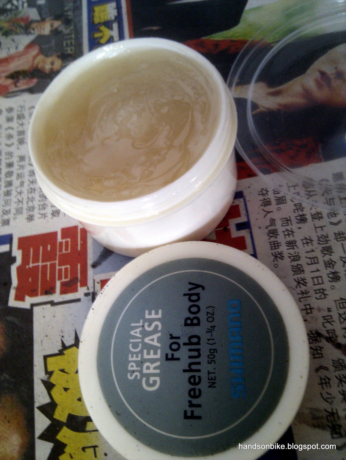

you can purchase shimano freehub grease:
i have a tub of it.
Cool I’ll check it out from Shim Aus - it looks very similar to slick honey/slickoleum/dt swiss freehub grease. Says it’s for fh-7800 which was the cartridge bearing one with serviceable pawls etc. Actually similar inside to a Campy hub.
