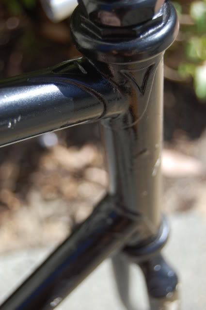

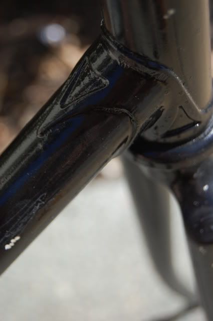

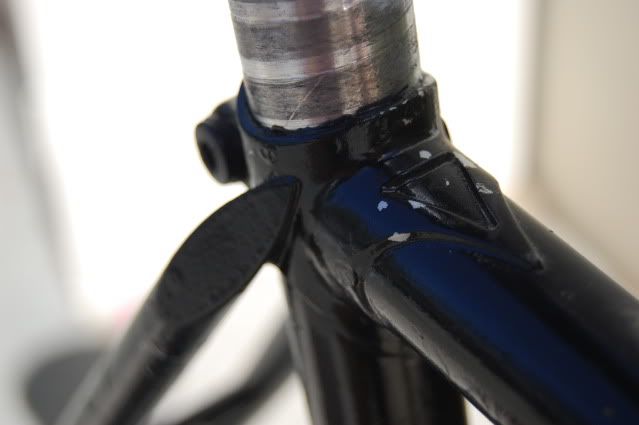

close up of lugs?
anything alloy shouldn’t be sand blasted if you ever want it shiny again, just hit it with a good quality paint stripper and some elbow grease.

Very similar lugs to my 80’s Pinarello but i don’t think they are uncommon enough to be an identifier.
Lugs and seat tube detail are the same as a Bundy I Just sold to one of the other lads. What’s it say on the fork crown??

The lugs look like Bocama “Competition 83’s” …
http://www.veloworks.com/lug_reference/bocama_gallery/pages/Bocama’Competition83’001.html
They were quite popular with many frame builders both down here in Oz and abroad. They alone won’t help you ID the frame builder.

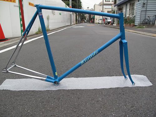

Does anyone know anything about chrome plating a frame before painting it?
Reason I ask is I had this appearance in mind:
(courtesy of kinfolk flickr)
Or am I just getting to ambitious?
Any chrome plating must be done before its taken to the painters. Its also not cheap but it is well worth it, i had my forks done and couldnt be happier with the results.
PS: If you do decide to have part of the frame chromed let them know of any engraving or stamping you want to keep because their pretty good at polishing them out :smiley:
