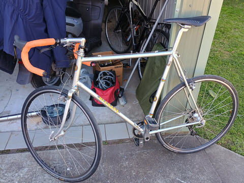

Cleaned it. First time in a long time. Back into storage it goes tomorrow.

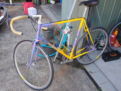

Also cleaned this and reset the front DiaCompe cantis. Probably take this at the retro day at Heffron and put it up for sale.
