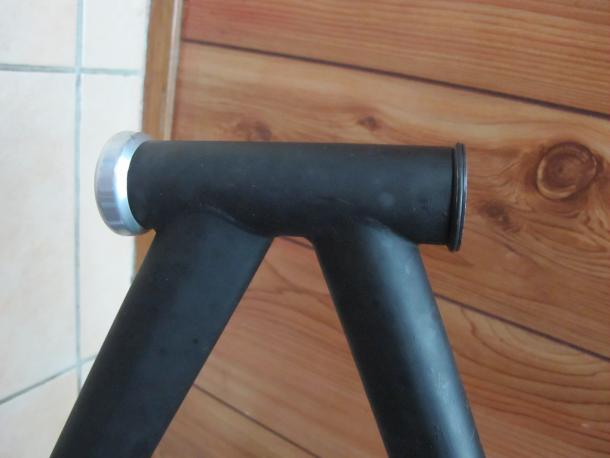

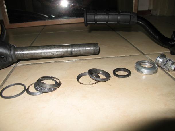

Here’s some pics. When I take out the piece (seal?) on the very left after the fork it fixes the problem, but last time I did it the fork started to get loose after a while. Not sure if it’s needed and why it was given to me but felt like it should go there. Is this the correct order?
Note: I didn’t include the shim or spacers in the pic.
It looks like your fork has a steel/alloy steerer tube, in which case it probably should have a star nut and not the expander nut. Might explain why it keeps getting loose. Take it to a shop and ask them tho, hard to tell what goes where without physically seeing it.
I can’t see that making a difference. Once the headset is preloaded with the top cap bolt and the stem bolts have been tightened, the star nut/expander doesn’t do anything useful anyway.
But I agree he should just take it to a shop.
