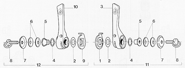

Anyone got number 1 and 8 in alloy??? any brand …
I’ve got a couple of pairs of mavic retro friction braze ones, if you want to keep the French theme? I’ve used them with a 10 speed!
