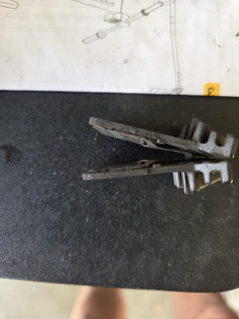

Front brakes were starting to make a bit of noise. “But I only changed them recently”
Ummm… from my maintenance spreadsheet it looks like the first pair I’ve replaced. It’s done 8000kms…

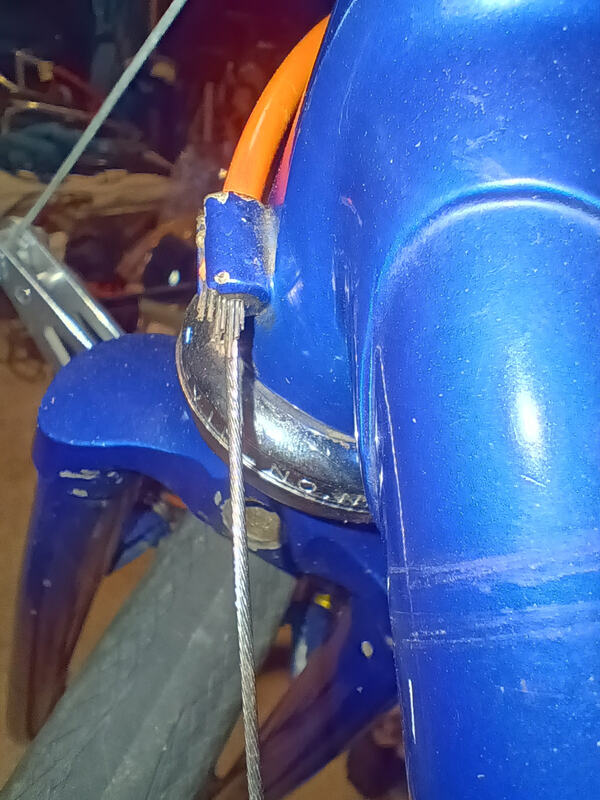

Wondering why my front shifter wouldn’t change up on today’s ride. Problem identified.
I’ve seen that happen to a lot of people recently. The wire twist gear cable outer just seems to eat thru the plastic end caps. Maybe we should all move back to metal ones :slightly_smiling_face:
Richard
That one has no end cap as it wouldn’t fit in the frame braze-on fitting. I have a few stepdown ferrules that I’ve made that I can put on to stop this. But am also debating about going 1x10 on this bike, so I may not need it. The brakes and top tube gear fitting seem quite capable of working fine. I think the angle of the cable didn’t help in this instance. The bend comes in pretty tight and might have made the load direction situation worse.
Why does the shifter cable enter the cable stop so sharply from the right side of the bike ?
What am I missing here, usually the FD is controlled from the left “brifter”, so it would be expected to follow a more straightforward path ?

All fair questions. A few reasons I can think of:
  1. The cable is already coming in at an angle due to nature of more modern double-hidden-cable brifters having it all below the bar tape. There’s only so far it can loop, so it’s a bit unfriendly from the start.
  2. It had a bar mounted bag on it (not the first time) which I suspect applied enough force to push the cable juuuuust beyond the point of system failure, something it didn’t do last time.
  3. The new Shimano FD (in this case a R7000 105) need a substantial amount of tension. Way more than anything this was probably designed for in the 1980s/1990s. Combine those three factors and you’ve got this failure. Nothing a ferrule and/or a little more cable can’t fix. But the bar bag mount is tricky to get right with this FD routing.
