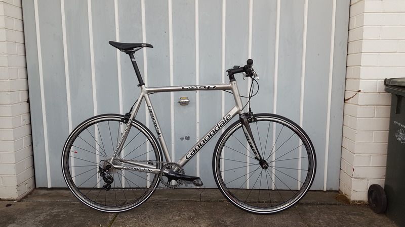

One photo for the moment.
Strip the stickas!
good one yo mans!
But how will he remember who made it and where?
I wish I was tall. Huge bikes look so good.
The grass is always greener, I prefer the look of smaller bikes!
Also, no stickers will be removed. I want all the freedom fries and all the branding I can get!
approved, much anticipation. So nice in that scheme.

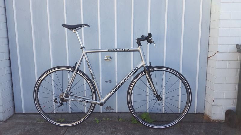

This has been sitting around for ages and it now going to be my 1*10 commuter.
Currently like this, a few more parts to come in.
Tyres are 28mm GP4000s, rear does not fit as it rubs on the brake. It previously rubbed on the brake bridge until I Dremeled that down a bit, then the caliper went on and NO GO JO. Will try a 25mm in the rear.
Does it rub on the brakes while cable is tensioned or not tensioned?
I found on some previous builds when you squeeze the calipers the arms move to make room so at the top of the tire it gives an extra few mm, juuust enough to run.
Interesting concept! Will give it a go this evening!
I believe it’ll need more than a few mm, but I’m up to try anything. (A 25mm tyre has been ordered already, if all else fails)

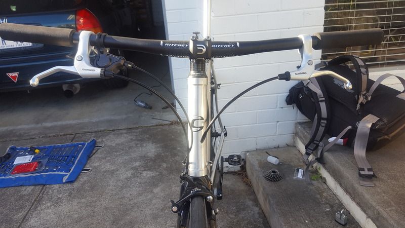

I’ve ordered a few items over the past few weeks as I kept on forgetting something, or I did have a compatibility issue with a road rear mech and mtb shifter.
The last package turned up last night, so I rushed home to put this bike back together. The days are getting shorter, #SOTB Is well and truly over!

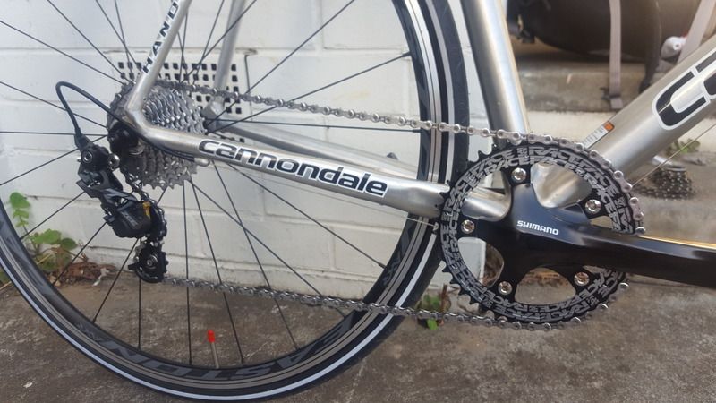

I want to keep it simple, so went with a 1*10 setup, very similar (the same) to what was on my Crave SL.
Shimano CX 105 crankset in 175mm.
Raceface narrow wide chainring 44tooth.
Shimano Zee rear mech.
Shimano XT 11-32 cassette.
Shimano XT (maybe?) 10 speed chain.
I’ve never actually installed a rear mech, so a couple Youtube videos were used to set it up. It shifts reasonably fine, I may have to fine tune it.

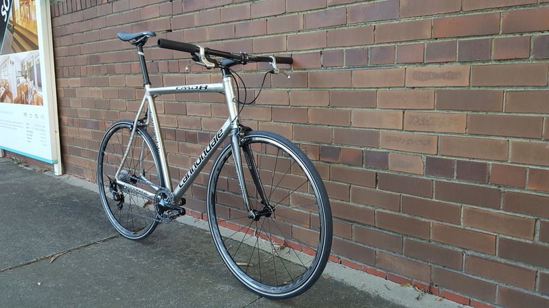

I rode it in this morning, with a couple stops to adjust my saddle position.
Very effortless, feels nice.
Fenders and a bell will be future additions, otherwise we are good to go.

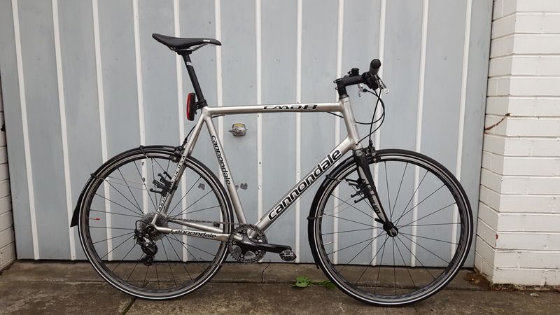

The winter bike isn’t a winter bike without fenders, and since the CAAD8 is a pure bred race machine and doesn’t have fender mounts, I ordered some SKS Raceblade Pro Stealth Series - XL to run throughout the winter period.
The front fit well, though I had to trim about 100mm off the brake bridge end for it to fit properly.
I think I’ll adjust the rear slightly as it does rub a TINY bit on some big bumps, though they seem to do their job.
Not as good as real fenders, but definitely better than an ass-saver or similar.
