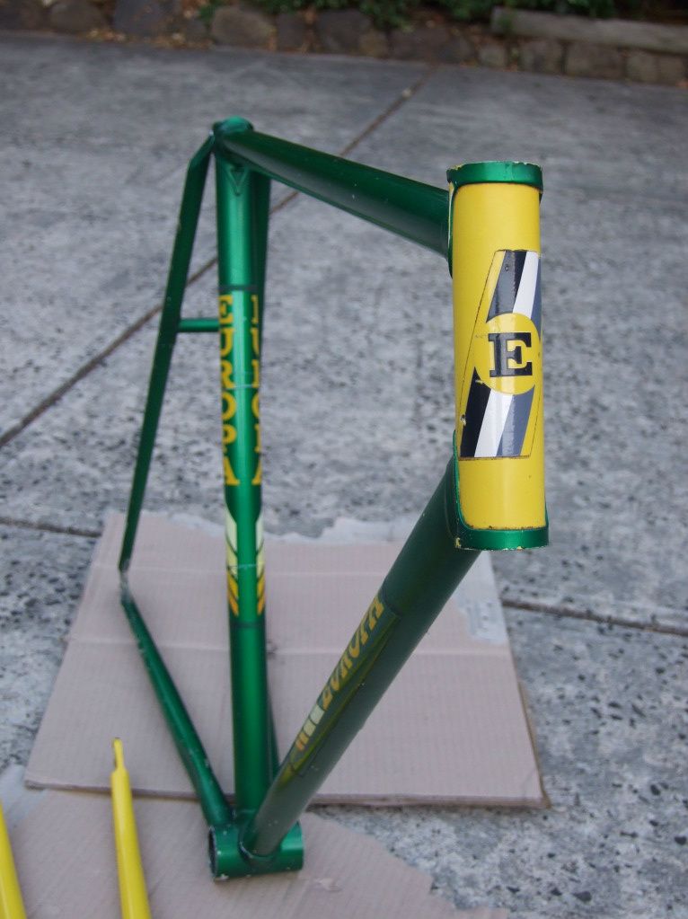

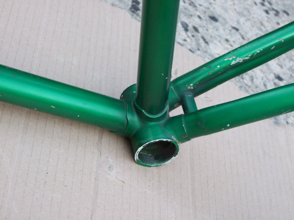

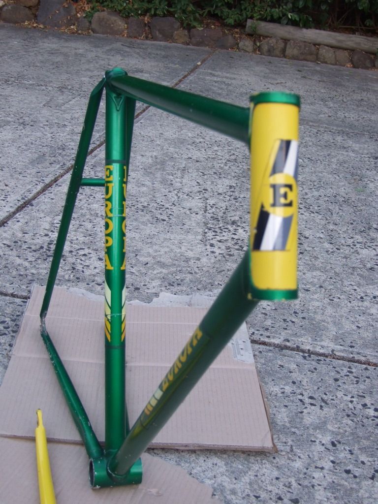

cleaned the frame tonite, got a bit lazy and didn’t do the head lugs all that well.
dried it down, grabbed the car polish and went to work. a few pics below.

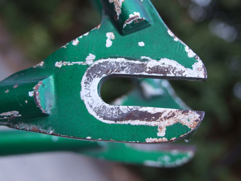

also nice to know it has some ID, campy dropouts on the rear…

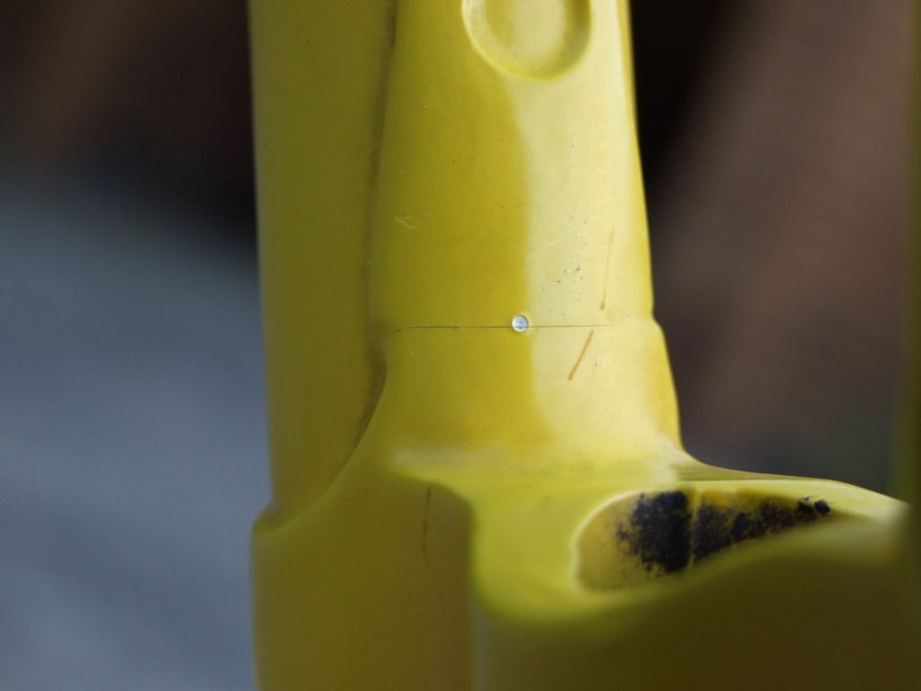

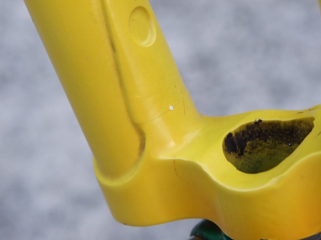

and now for some not-so-good news:

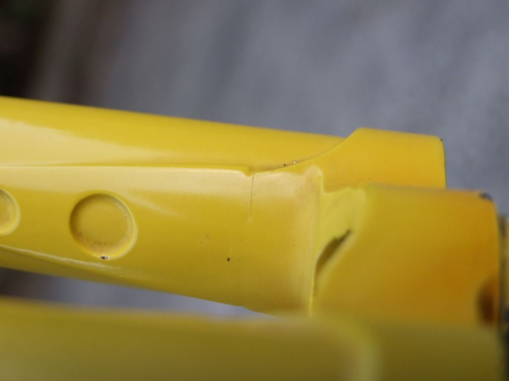

right blade a crack goes halfway along the lug, the left blade crack goes the full length across.
Frame looks a treat, shame about the fork…

Frame looks a treat!!! Get a builder to look at the fork? See if it’s repairable!
You’re so sweet.
It’s not a crack, those long fork tangs are separate to the fork and brazed in place to help support and stiffen the blades. Your fork wasn’t filed and smoothed and what you see is just a little sloppy workmanship. It’s not bad, just means the builder had better things to do rather than worry about people on the interwebs would think 30 years later.
Fork’s fine … good to ride.
^ What he said.

I got a better pic to explain below featuring richie sachs Newvex Crown and tangs…

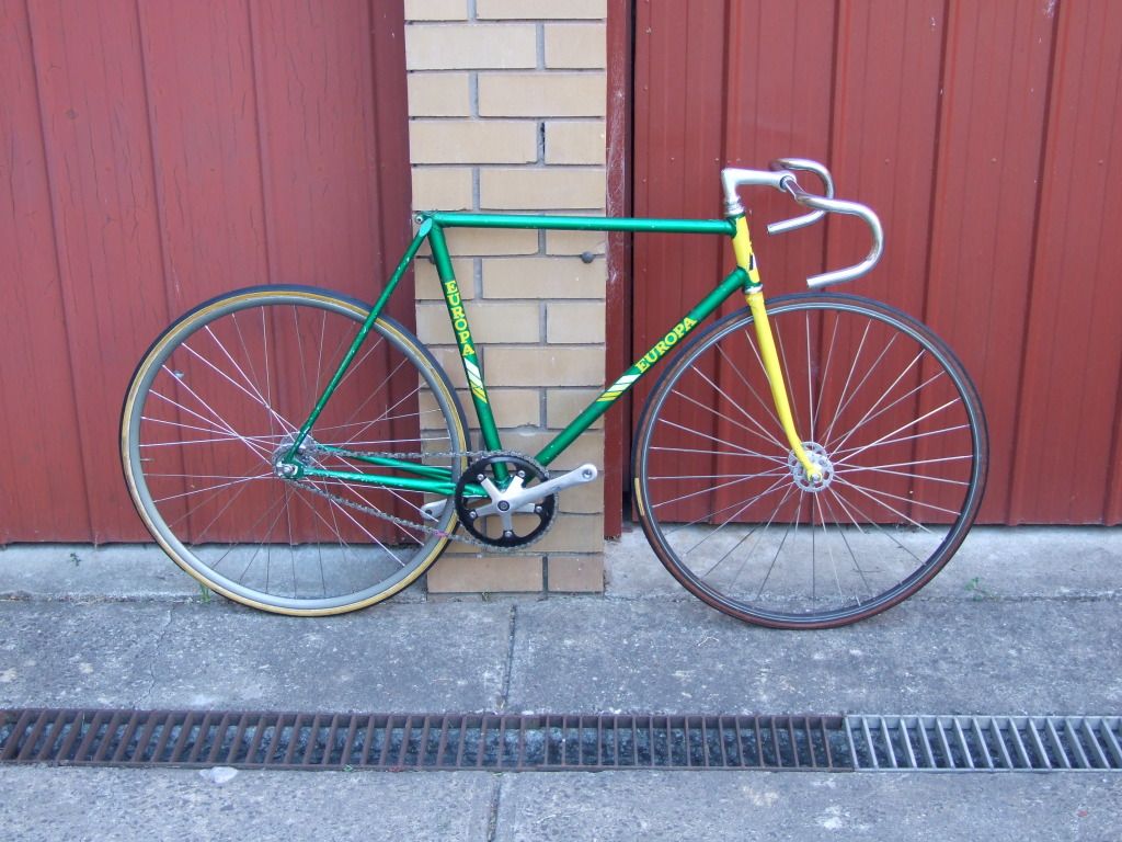

in the meantime, i dropped it off to Commuter to install a Tange headset. was gonna wait til saturday to pick it up, but am too eager, so will grab it on the way home and shove it in my bag to being assembly tonite. hopefully it doesn’t smack me in the head as much as it did on the way this morning.
Sweet! Can’t wait to see some build pics!!!

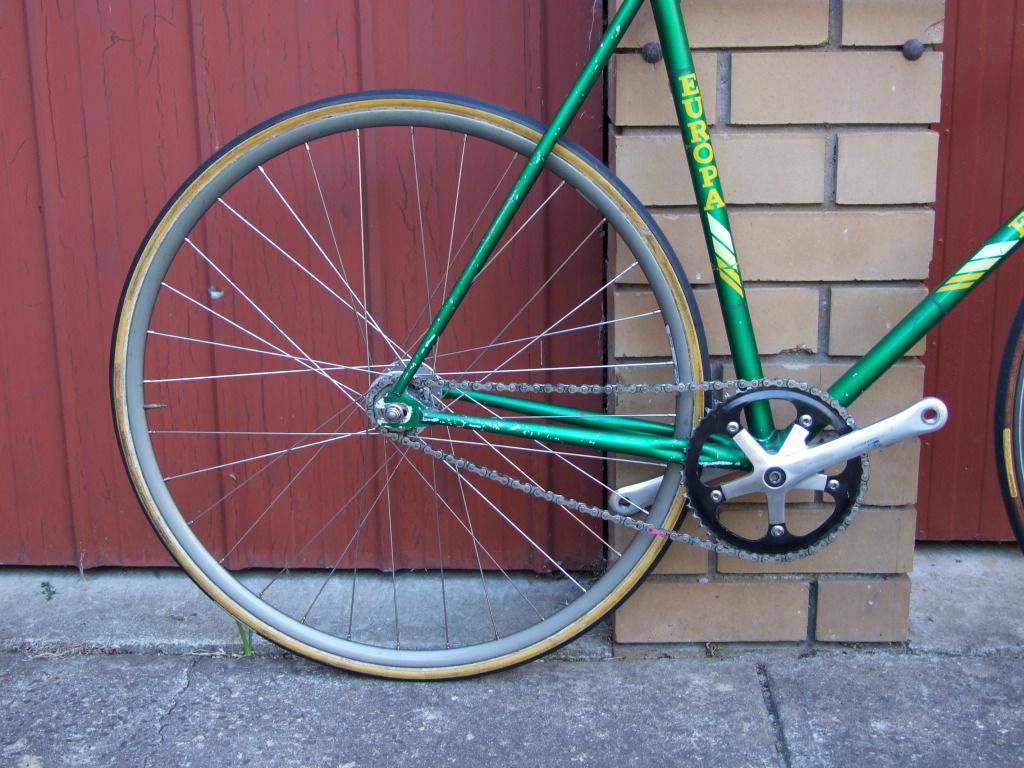

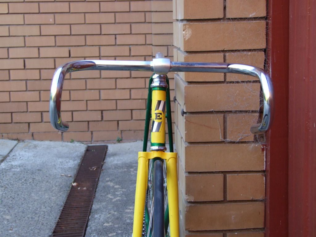

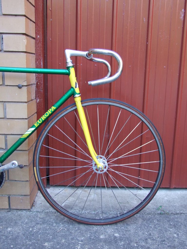

that’s enough word talk, here’s some pics…totally ghetto, but i’m racing it, not walking.
did you use a t handle wrench to tighten the stem? A ball end Allen key isn’t sufficient.
nope, i cheated and used a full straight allen key with some ring spanner leverage. i’ve never like the ball ended ones.
