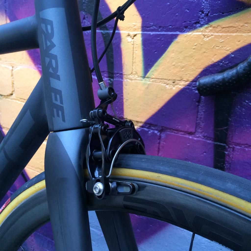

I have a plastic front fork that is 1000% better than my steel ones,
It corners and handles like nothing else but it is an enve 1.0 taper.
I also added these for less weight and better performance
