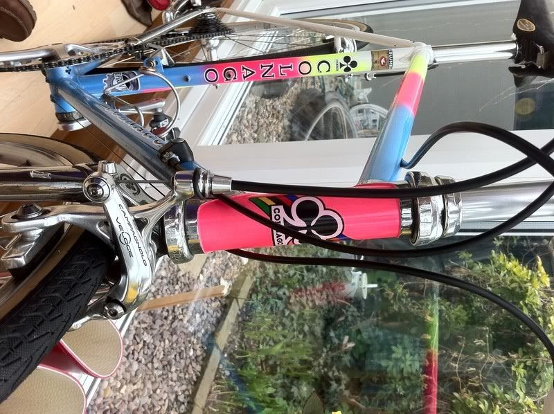

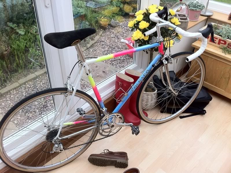

I recently purchased this off gumtree at an amazingly low price, and I would like to work out what model it was. It has colnago stamped dropouts, and the serial number on the dropout is 1b723
The original owner told me it was made from columbus sl tubing and that he purchased it 17 years ago.
I’m pretty sure it has a 94 ergo groupset with some C-Record parts. It also came with Deltas. I think the cranks and deltas have the century finish but I am not 100% sure. I will let the pictures do the talking. But any insight at all would be appreciated.

It’s definitely a colnago alright.
haha yeh that’s about all I know!
C94? That would be consistent with the ergoshifrt + delta group.
Ask user toff at http://www.bicycles.net.au
I think/99% sure it is a 1989 Colnago Super:)
it is almost exactly the same as this one pictured, which is an 89 super. It even has a similar paintjob:)
Now to begin with the build:)

Is the group original? If so it can’t be an 89. The super was a low end model and I think your’s is a either a higher end or later model or both.
I think it fits somewhere between these 2…
This is an 88 super:
This is a C94 (not original fork though)… with the rear brake cable entering the bottom of the top tube, not the top.
hmm thanks for the investigating :slight_smile: maybe spirito will know?
update
I don’t think the group is original. I think the cranks, Deltas and Headset are original, as they have the century finish. They where part of the 91 Record group set. But then the owner may of upgraded to Ergos, replacing the front and rear derailurs, as well as the levers. So that makes the frame pre 1991 or earlier?
