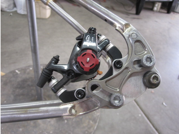

When using calipers like the Avid BB the cable housing points directly at the chainstays making a nasty little bend in the cable, you can see from this image
Can be worked around but is a good idea to keep it in mind

Here it is:
No problem if hydro, which I’m hoping will be an option soon.

Workaround with a V-brake noodle?
Ah I see. It is in the most rear position on the photo though, and wouldnt routing the cable on the bottom of the chainstay solve it?
Still a better setup than my pompetamine: When sliding the wheel back in the dropouts, one of the caliper adjustment bolts/the caliper mounting bracket hits the rear stay, making proper adjustment a pain in the ass unless the axle is in the 50% (or so) of the dropout closest to the bottom bracket.
