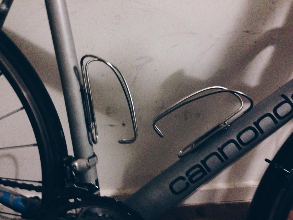

Hole too big for rivnut.
Just got this message from BMCR. I took the Cannondale in to get a rivnut installed today after I got the loose one out
We’ve looked at your Cannondale, and unfortunately the rivnut cannot be replaced as the hole in the frame is too large. It appears that either someone has drilled out the old one using the wrong sized drill bit*, or the old nut had been spinning in the frame for so long that it wore the frame away**. Feel free to collect your bike as soon as you like – sorry we don’t have better news for you.
Any other suggestions to fill the hole so I can attach a second bottle cage? Or is there a bigger rivnut that I can buy and install?
  • wasn’t me
** maybe have been me
head on over to rivnuts.com, seems you can get up to an M10 rivnut, guess you’d have to drill out the bottle cage to the size of the rivnut/thread.
Ribbed L Rivet Nuts | Rivet Nuts & Threaded Inserts
an M6 rivnut? they have M8s too.
http://www.ebay.com.au/itm/Qty-1-Countersunk-Smooth-Nutsert-M6-Stainless-SS-304-Rivnut-0-5-3-0-Thinsheet-/231269751787?pt=AU_Car_Parts_Accessories&hash=item35d8c05beb&_uhb=1
then DIY
Okay cool. I’ll measure the hole with some calipers this weekend and go from there. I’ll ask BMCR what size they tried using.
Hmm, dunno if the parktool method will work with M5+ rivnuts as it uses a QR to thread onto the M5 thread of the rivnut.
Might have to use the actual tool.
or make your own tool.
Cheers.
Success! Thank you so much MikeD. It worked perfectly and cost me under $8.
I measured the hole with some calipers and bought 5 M6 rivnuts off of eBay for $3.99 (free postage). I then bought some M6 socket head bolts from Bunnings ($3.15 for 3). The rivnut fitted in the hole snugly and using this DIY method with one of the hex bolts and a bigger M8 nut that fitted loose on the bolt I tightened the rivnut. The bottle cage holes fitted a M6 bolt as well, so I didn’t need to drill it.
Wondering how easy it would be to install rivnuts on a steel frame now.
Sick.
I was stoked. I am genuinely surprised how easy it was. Pretty much everything else with this bike has had some sort of issue.
