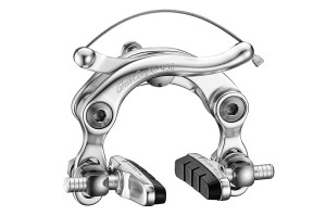

There are short reach centrepulls:
http://diacompe.longwang.com.tw/product/gran-compe-450-centerpull-brake/
And the arms do move away from the tyre under braking.
But you then have to put hangers somewhere too.
Single pivots often have better clearance, older campy (80s) brakes can be spectacular in this regard.
