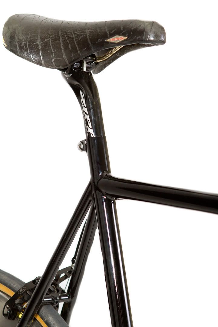

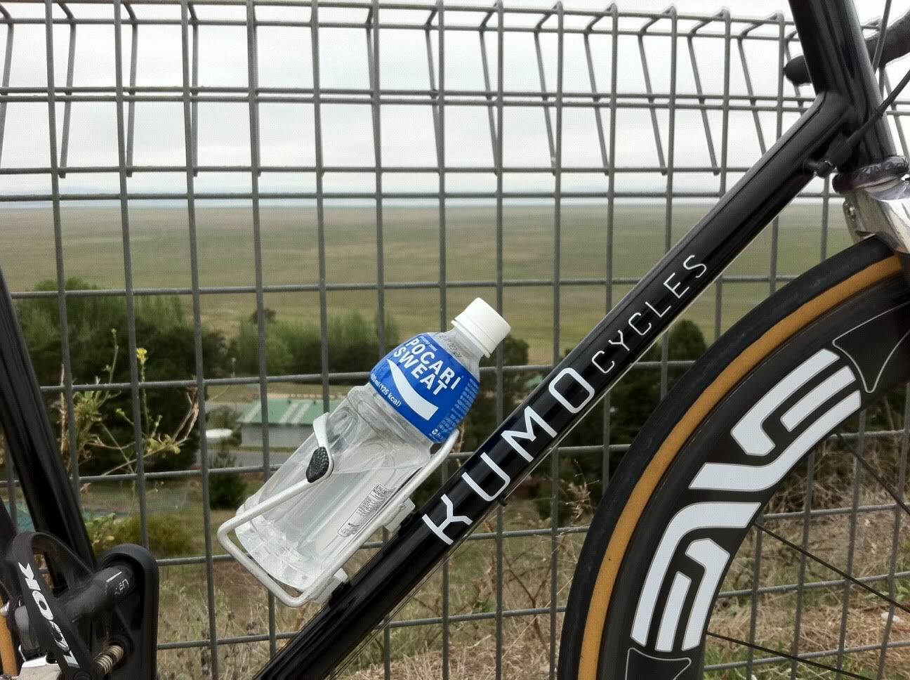

Number 2 (of 4) in the Kumo Cycles repertoire, TIG welded and Fillet brazed Columbus Life frame, built by me, for me.
Named the bike Karasu, crow in japanese cause it is fast, black and I occasionally have to reign it in when it spots carrion on the side of the road.
Finished it yesterday and have clocked up about 150km on it so far, rides fast, smooth and awesome
Its no weight weenie at 8.7kg, but then again neither am I

Wheels: ENVE 65 carbon clinchers, wrapped in Challenge Paris Roubaix 27mm tyres to provide cushin for the pushin (I’m sure Mr Dylan would approve)

Seatpost: Zipp
Saddle: Well loved Rolls

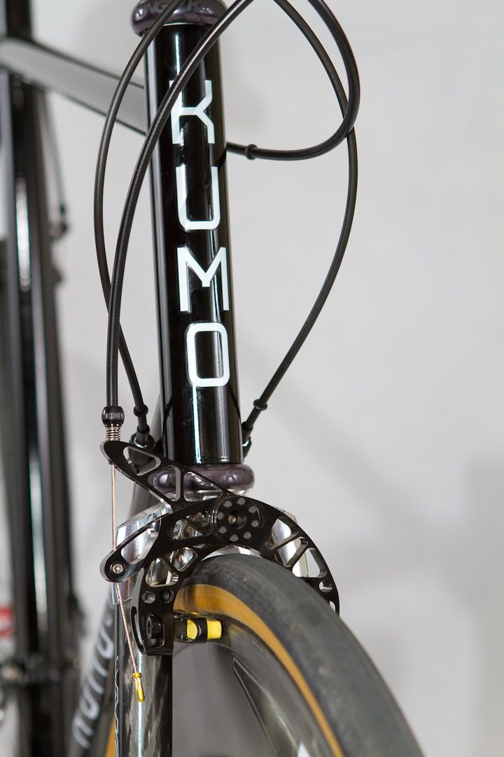

Brakes: Brams M5 Ligfeitsen with swiss stop yellow pads

I suppose fillet brazed Columbus Life would weigh a little more than if it were TIG’ed, but not much?

and yeah the fillets add a bit of weight, probably about 15-20 grams so not a whole lot to worry about.

nice choice of parts too. one word of advice … the new enve brake pads are 1000% better than the swiss stop yellows, way less grabby and they don’t wind up smeared all over the rim ( making them more grabby helping build more heat ) they also reduce heat build up at the rim by a huge amount which given your running clinchers is a very good thing, plus they are a dark grey colour which will match your fabulous bike even better

Cheers for the advice man, will definitely track down some ENVE pads, I did look into it before I got the swiss stops but was having trouble getting them here
