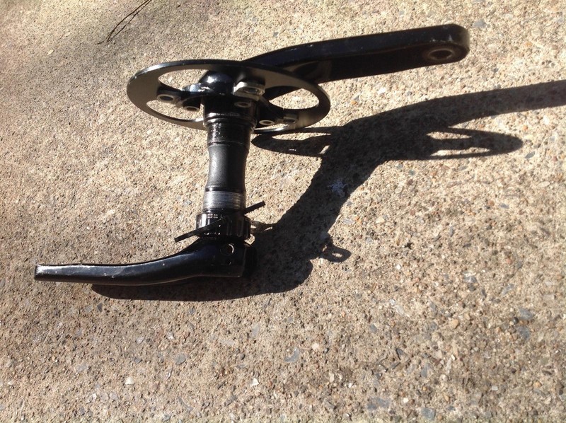

Hi all,
About to pull the trigger on an used FSA Gravity crankset, which comes with a 73mm Mega Exo BB. I need to switch to 68mm. I read conflicting info on compatibility between this and Shimano Hollowtech II.
I don’t really want to spend 50 bucks on a BB for a 40 buck crankset because I am cheap.
So can I go with a Hollowtech BB?
Thanks!
I have fitted FSA gossamer and energy cranks to shimano hollowtech II BBs with no problems. Whilst megaexo is supposed to be the same dimensions, I think there is a minor difference that can prevent the shimano BB from working properly on SLK megaaxo cranks.
How that relates to a gravity crankset ¯_(ツ)_/¯
You could probably add some spacers to fit your 68mm shell with the included BB, but FSA BBs are junk and won’t last long.
You then might be able to get a shimano MTB BB and install it with the included spacers for a 68mm shell. But buying the cranks and not knowing is a risk that might not be worth it.
(ignore the arrow)
I think I should put you on a retainer, given all of the info you share with me regularly. Something tells me that it might be easier to go with a full shimano setup rather than screwing around and probably making a mistake :slight_smile:
Sounds like a better idea.
