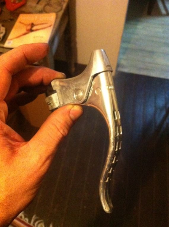

Got some shimano non aero brake levers and I am trying to find a set of replacement hoods, they are BL-Z306 which are the 105 golden arrow jobs I think.
Anyone had any experience getting replacement hoods? The cane creek/dia compe ones look like they might fit, but before I get em thought id ask.

Ridgeways has a few to choose from, but dia compe ones in gear should fit
These are the original hoods for your levers. A but pricey though so you may want to look for hoods similar to this shape. Don’t get the square/boxy one’s as they’ll be loose on your lever.

Ok sweet thanks, was hoping to get out of it for a bit less than NOS sort of prices, will have to trek out to ridgeways and have a look
Actually there’s some good alternate choices out there. It’s hard to say but I think these might work … compare them with the original Shimano hoods for shape and take a punt.
Diacompe NON Aero Brake Hoods Brown | eBay
The Dia Compe shape is pretty good. I bought some Cane Creek ones a while back, but they’re boxy and didn’t fit the 3 sets I had - Suntour, Shimano or Modolo.
