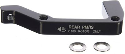

Are you trying to run post mount calipers on a flat mount frame? This is what can be adapted.
Because you can’t adapt flat mount calipers to a post mount frame.
No, other way around. Im trying to run flat mount calipers to a post mount frame.
Isnt that what my link is showing though? Post mount to flat mount calipers? or am i reading that website wrong?
I figured as much. It’s unpossible. geometry gets in your way.
Those POST MOUNT TO FLAT MOUNT adaptors are to adapt POST MOUNT calipers TO FLAT MOUNT frames. Shimano also makes these adaptors (see in below photo)

Your link shows post mount caliper to flat mount frame/fork.

These aren’t what you’re looking for?
Or is this for flat mount fork to post brake?

I ordered the above.
Nope, this converts IS to PM. A very common adaptor as there are nearly no native IS mount brakes these days, but there are still IS frames/forks (very damage tolerant, you can strip the threads in the cheap adaptor without ruining the frame or caliper)
EDIT: Moccos if you have an IS mount frame, then that adaptor is correct to use with PM calipers.
An IS mount fork looks like this:
