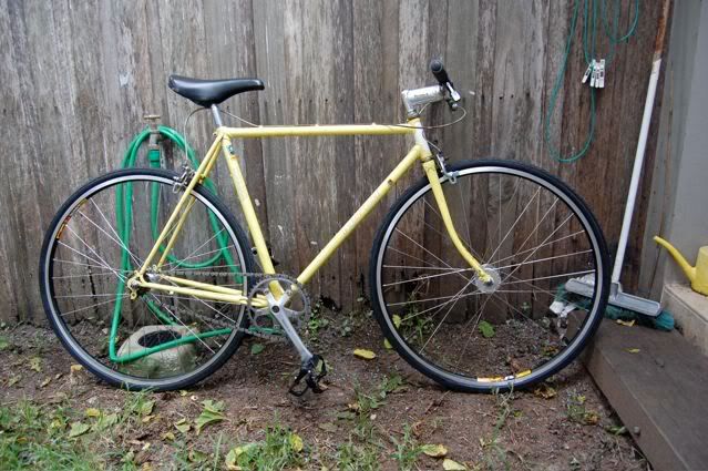

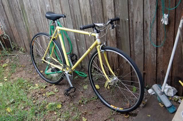

Here is mine, currently awaiting a new build but was my commuter for 2 years, it has filled in horizontal dropouts that I took to with a drill and a file to make them horizontal.
