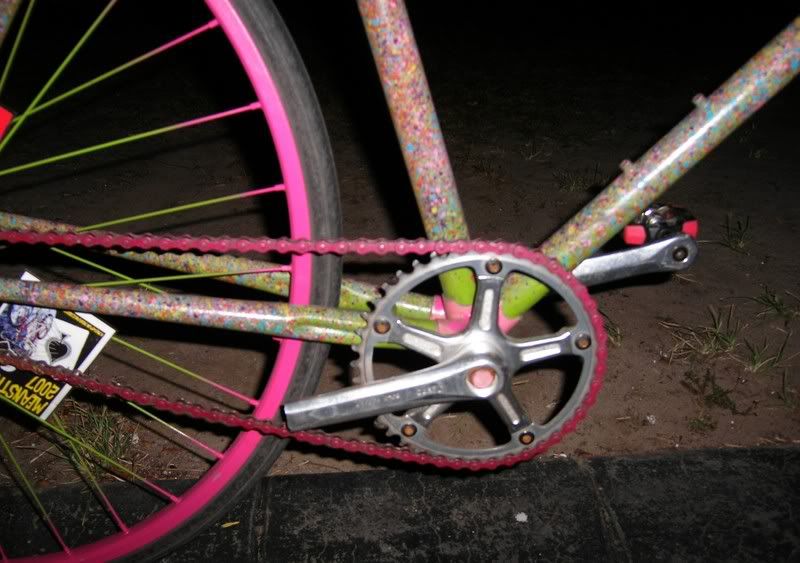

I’m putting a double Sugino Mighty Competetion crankset on my next build. I’m putting the inner chain rink on the outside, hopefully it won’t be too much of an issue once I replace the bottom bracket. I can’t see why it would cause terrible problems.

Or… you can do this:

You can make it work quite well and get a perfect chainline, but make sure you don’t use shitty poor quality cranks! Or else…
Or you could run 3/32" and save yourself a buck or two on chainrings (as I have without incident on about 4 consecutive fixies). Still might involve the same tinkering with bottom brackets (or chainring spacers etc etc etc) to get chainline right. I’m currently using old campag chorus cranks with a 111mm bb and chainline is spot-on.
