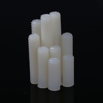

If you really want to block them off (assuming there are no other entry avenues anywhere) or keep the threads clean just spend $3 on these. Even lighter.

You can find inexpensive plastic plugs for what you want to do. Won’t be as fancy as ti screws for sure, but they are very low profile compared to screws which will be bulging out a bit.
