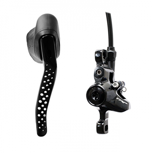

So the monsterslate 2.0 has been going great guns, but i feel like i want hydraulics on it now.
Are the TRP Hylex my only option for a SS hydraulic drop bar set up? i guess aside from buying regular hydro brifters which would get exxy.
I like the idea of not having to worry about steel cables and the added modulation/power would be welcomed.
fanx foa

TRP Hylex RS is the go.

unless you want to run a hybrid system, TRP parabox, TRP hy/rd, juin tech r1 etc. or hack out some mech/di2 levers (sram do a 1x LH lever, but you’d still need a RH)
hylex will run you what, $280 (or $230 for those takeoffs). What’s a set of compressionless housing and some better pads cost?

Geoff, cheers, PBK/Wiggle have for about $130 for lever and caliper, so about $270 for a set, Hylex levers are just uglyyy
Blakey, i like the sram levers so plan was to find some 2nd hand rivals and hackout the gear mech. Yeh, Hylex is like $270 for a set
Currently running TRP Spyers to SRAM S500 levers, which are fine, but have had to do a few emergency stops recently and takes a bit of power to slow the tank down!

If anyone is on the fence about the TRP Hylex levers, I highly recommend them!
I think worth the price, specially if your coming from full mech brakes. If your coming from semi ie HY/RD, Juin Tech, Yokozuna etc it might feel less of an upgrade.
But after a couple of weeks of commuting, specifically in the wet, the added power and modulation is very much welcomed.
Im not a fan aesthetically of the curved levers, but function definitely > form in this case, very comfy to use on the hoods.
Speaking of the hoods, the only real issue is the hoods themselves, they are fairly long. I have small hands so while I find it super comfy to ride on the hoods, I did have to run a slightly shorter stem (MTB geo also doesn’t help)
