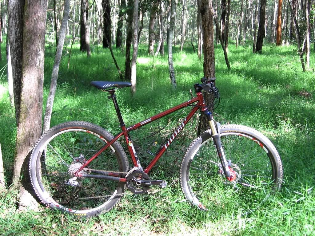

I use Blunts on my 29er.
They’ve stood up to a good amount of riding singletrack and obstacles.
I don’t jump the bike much, though I don’t mind a little air-time.
Only problem I’ve found with them is fitting slicks - they are a 28mm wide rim, so 32mm or wider 700c tyres are required.

Nice Niner BTW. Picked up a KHS Tucson frame and Tora on evilbay, let the fun begin. :slight_smile:
