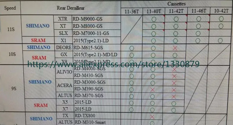

This table accompanies the 11-40t 9sp cassette online:

Woah some of these shadow derailleurs are hideous
Alivio m4000 shadow is nominally 9sp and has a sweet barrel adjuster, goes to 36t cassette on shimano’s conservative specs
What Blakey said, I’ve got an Alivio m4000 and got it to work satisfactorily with a 11-42 cassette.
Sweet, I’ll pick one up. Woo! Easier climbs
