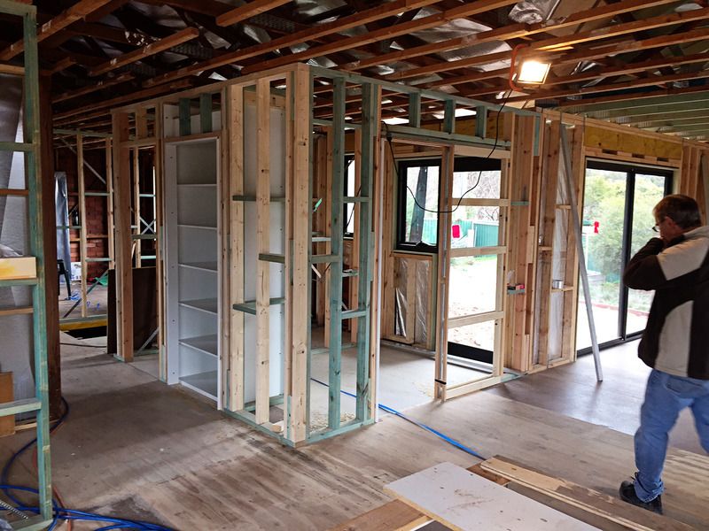

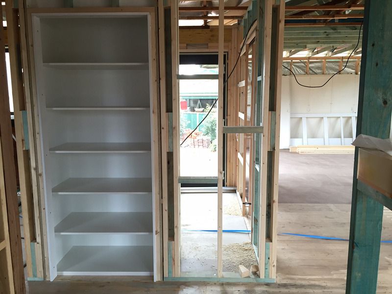

Ivan built our linen cupboard which backs onto the laundry. The laundry walls are all up now and the cavity slider door is in. We will need to get all the plumbing roughed in next. Then I will head back under the house to finish off the insulation. We also took delivery of our tiles for the wet areas.

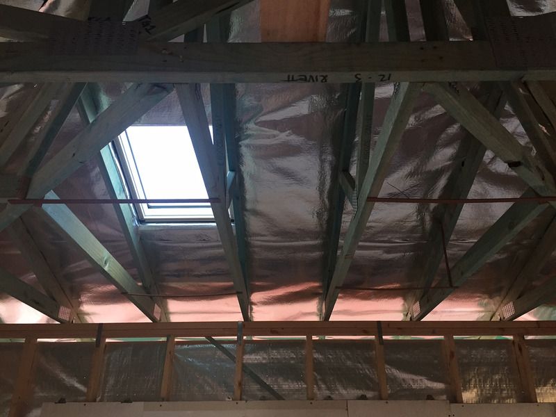

Next weekend we will be installing a couple of Velux skylights which will be placed above the kitchen island bench. This will ensure we get as much north facing light into the kitchen as possible. This wasn’t in the initial budget, but I have been working some serious overtime at work so I thought I could treat the house a little.

Cupboard looks good. When I see where it is and what it backs onto, I remembered my grandmother had a linen closet that was accessible from both sides in her Laundry. So she could bring in the folded washing from the line, or the drier, through the laundry and straight into laundry side of the linen cupboard. Then when anything was required it was accessible from the other door in hallway the bedrooms were on.
That is bloody smart! Hmmm.

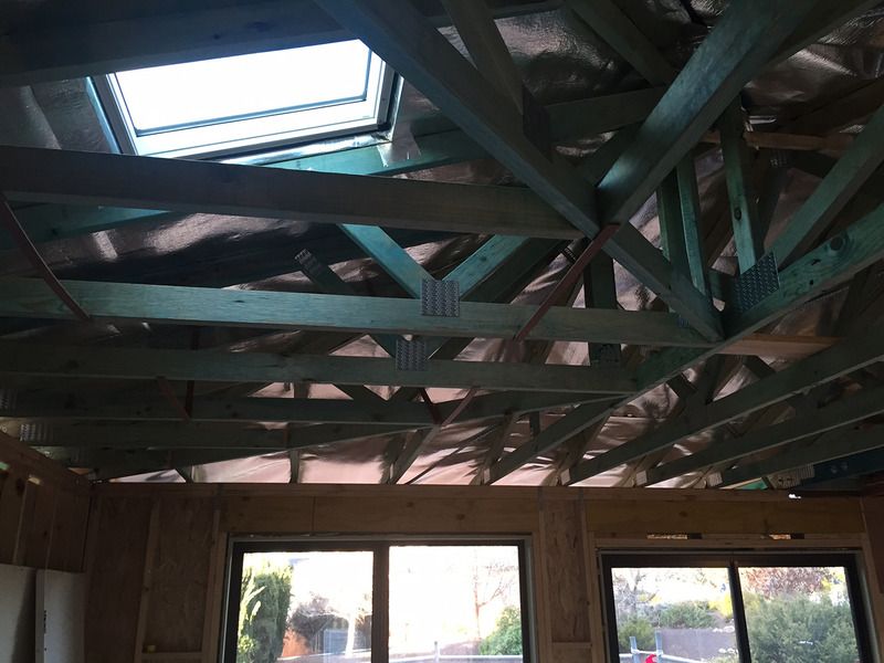

The main thing though was an installation of one of our skylights. There will be another one installed next weekend. These skylights will sit over the space in-between the kitchen island bench and the kitchen cupboards. It should be a nice kitchen to spend a lot of time in!
