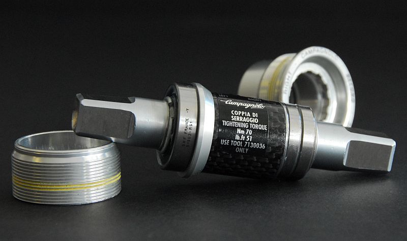

so are the catridge bearings in a campy pista bb open without dust seals?
that seems weird that they wouldn’t have any seals - even phils have exposed bearings?
I can’t really tell from this picture
The cylinder on the lefthand side of the BB is a sealed bearing.
But be careful…
‘sealed’ can mean loose ball bearings with a dust seal, as opposed to a sealed cartridge which does not have user serviceable loose BBs (although sometimes you can, despite what the instructions say) and are generally better protected from the elements.
The Record BB above uses sealed cartridge bearings and are not intended to be serviceable (probably so Campag can make more money).
Those bearings are the SKF ones as in the Record and Chorus eh? In that case they’ll be unservicable.
when we pulled my 3yr old chorus bb (totally ratf#cked) earlier this year, dan shifter noted that the bearing were actually a common type and could be replaced without lining campys pockets. not sure if this applies to record et al, but worth knowing before you buy a whole new BB.
According to my cupboard, the Chorus and Record have the same bearing sizes. Looks like there’s 3 smaller cartridges on the drive side.
I don’t think there is such a thing as a proprietry sealed bearing. Go to any bearing shop and quote the number on the bearing and you will most likely be given the choice of several bearing manufacturers. Most are easy to pop out and drive back in if you know what you are doing.
I haven’t replaced the bearing on a BB before, but have done a few (velocity style) hubs with great success.
