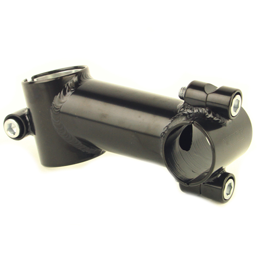

I just bought one of these:
Due to some Japanese / English translation issues, I thought it was 26.0, not 25.4. Can I run 26.0 bars in this or should I try and return it and get my money back / exchange?
