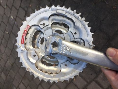

Stripped thread on crank arm so my crank puller wasn’t helping.
angle grinder to the rescue. image
