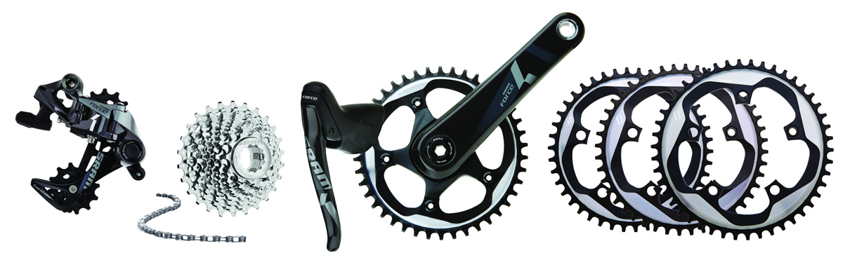

CX1
Force with just gearing on the right side. 119g for the left lever, 158g for the right one. Right is exactly the same as Force 22. And then a Force crankset with carbon fibre arm and a spider for a single ring with a bcd of 110mm. Cx1 chainrings available in 38, 40, 42, 44 and 46. A 42t is 75g.
No XD Driver. Sweet!
Question about the 110BCD Force chainrings- can you mount these onto any standard 110BCD road crank?? The SRAM XX1 chainrings do have special threaded bolt holes…
Given it’s a regular force22 crankset, I’m going to guess that you can. Unless they are threaded and similar to XX1 / Red 2013 and are M8.5x0.75 not M8x0.75
Ask slinky.
Or just buy a raceface/wolftooth 110 ring instead.
It’s just a Force crank.
looks like bolt and nut on these pics… I’m assuming XX1 uses no nut if it has threaded rings? But i dont care either way… good reason to look at these pics, eh?
