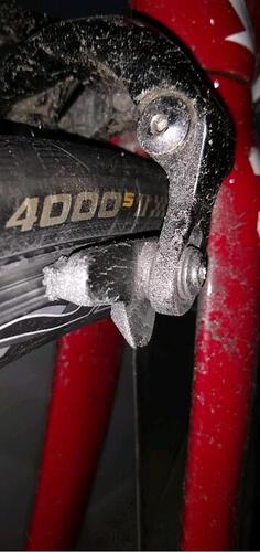

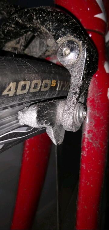

I posted this on BNA. Rim brakes, aluminim rims and wet weather;
A 60k commute in for night shift on a wet day. Sand and grit in the pads. Braking wasn’t quiet or particularly effective either. Aluminium from the rims all over the brake caliper and on the fork legs. I do not miss rim brakes (or wet weather).
Fair enough. Looks like a bad combination for sure.

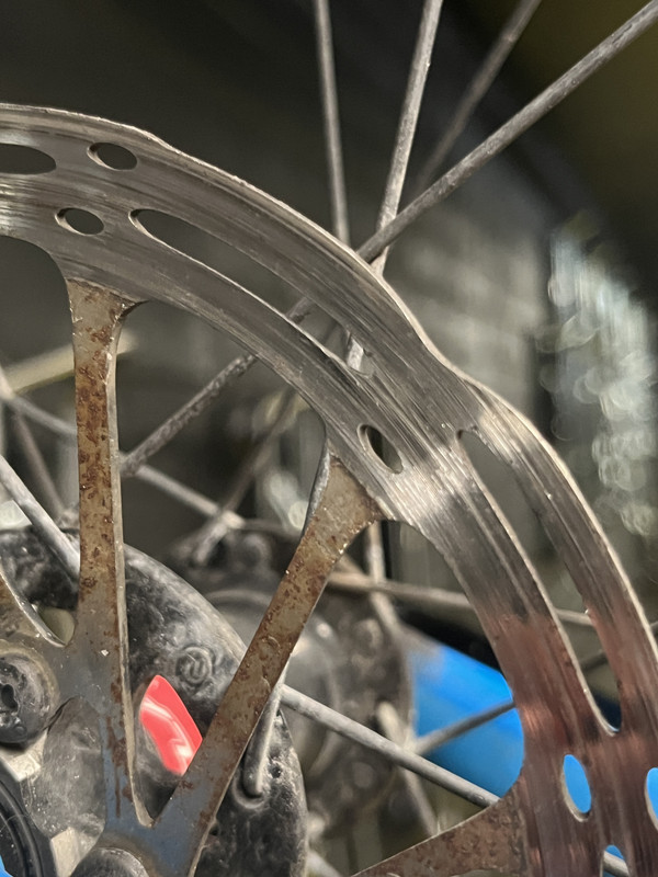

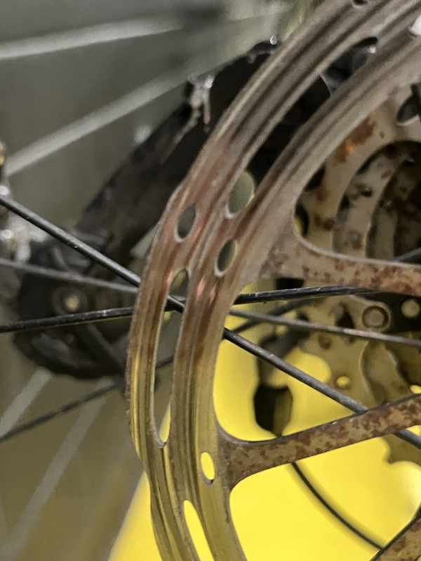

Torched the discs, sanded the pads. No difference.
If anything, probably worse now that they seam to be squealing in the dry. Not as bad as the wet, but still annoying.
What’s next, new pads?
reckon so, must be some serious contamination
New pads, especially if you didn’t already. It’s generally a given for dumped bikes with discs, I’ve rarely gotten away with leaving pads in a kerbside pickup yet (4 so far). I had to try to resuscitate a rear set of pads on the Cube on the weekend, but no luck. They glaze over almost immediately on application for some reason.
I did put on new pads when I got it.
Here are close up shots of the rotors - you can definitely feel scored grooves, particularly the rear.
The bike had been fairly thrashed before my tenure.
Should new rotors be on the shopping list?
they look cooked.
got verniers? how thick are they?
SRAM replacement is at 0.3mm wear (so 2->1.7 or 1.85->1.55 depending on model), shimano is similar, 1.8->1.5)
Front is 1.88, rear is 1.76.
Centreline rotors are 2mm thick new.
Although did laugh at the spec: Thickness: 2mm (Minimum thickness 1.55mm)
The noise minimum appears sooner I reckon. I’ve tossed Shimano rotors that wouldn’t stop howling at 1.8. Which solved that problem but YMMV.
I’ve heard similar in that thicker, heavier rotors squeal less.
