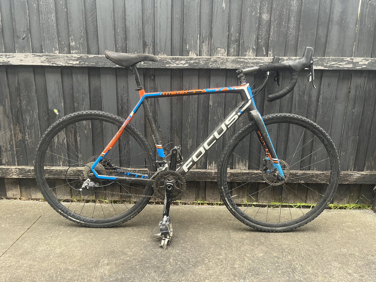

However, while my daily is in the repair queue, I’ve been commuting on a Focus with Sram Rival hydraulic disc brakes. Just to add some context, this Focus was a hard trash find which I’ve been slowly bringing back to life.

Here’s a picture:

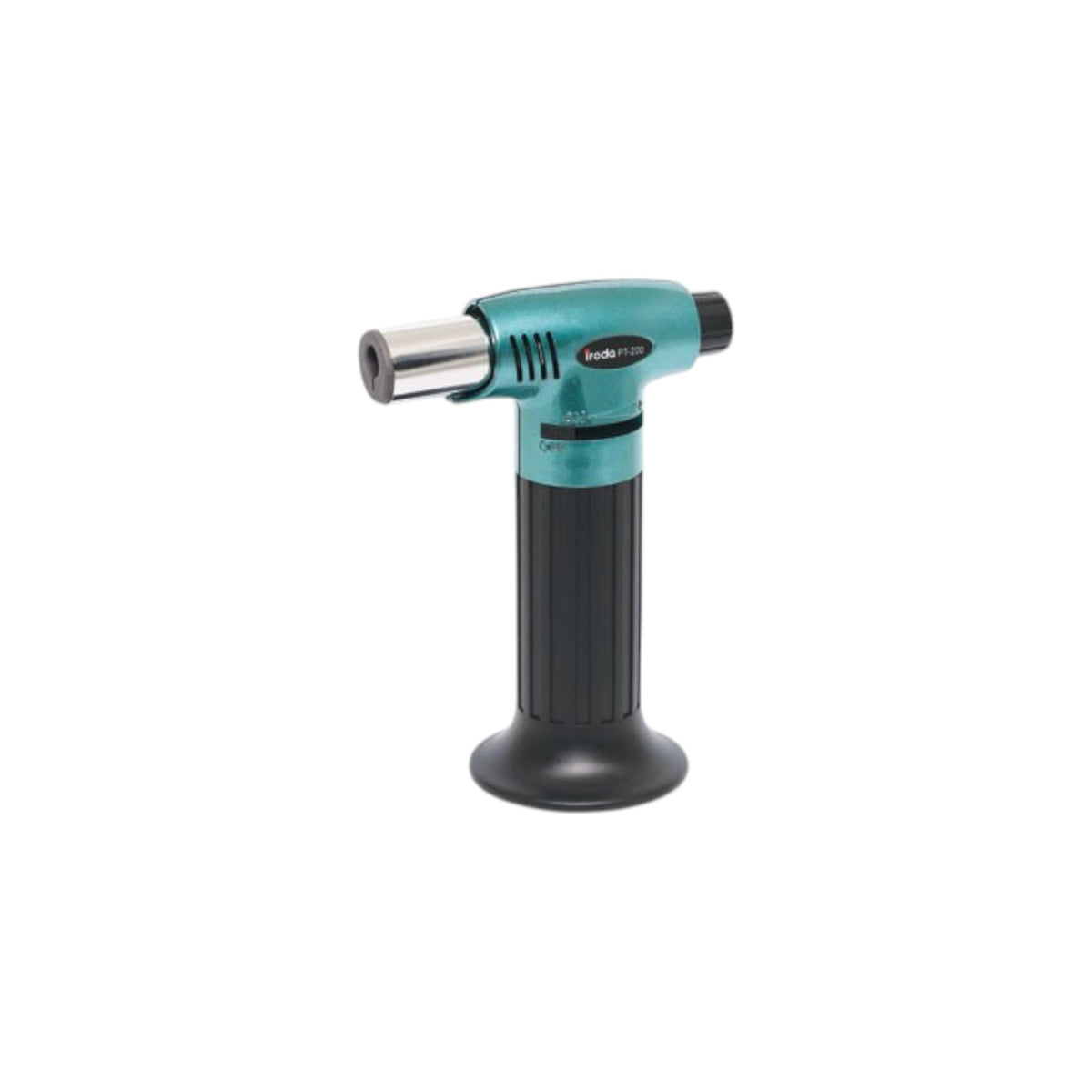

Do you think something like this would do the job? Samba Jet Flame Lighter - Bunnings Australia
I assume the idea is to burn the muck off.
that’ll do it, it’ll burn any contaminates off
That will work. You’ll see any contaminant moisture boil out of the pad material pretty quick.
I found one of these on a ride, has been great for pad cooking:
strong endorsement of this.
