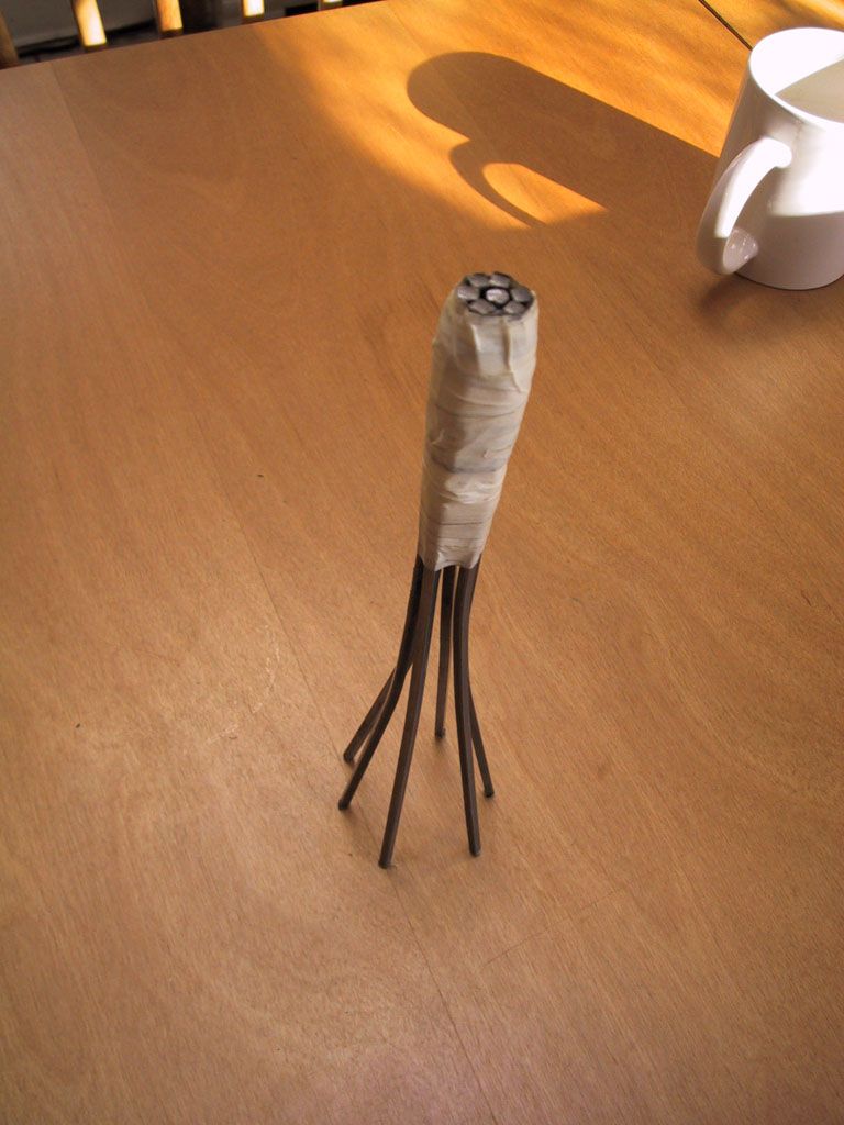

something like this should get the cups out

Here’s a simpler version that works just as well:
And here’s my aluminium version that I used successfully (scroll down a bit), although I admit copper would have been better, if more expensive:

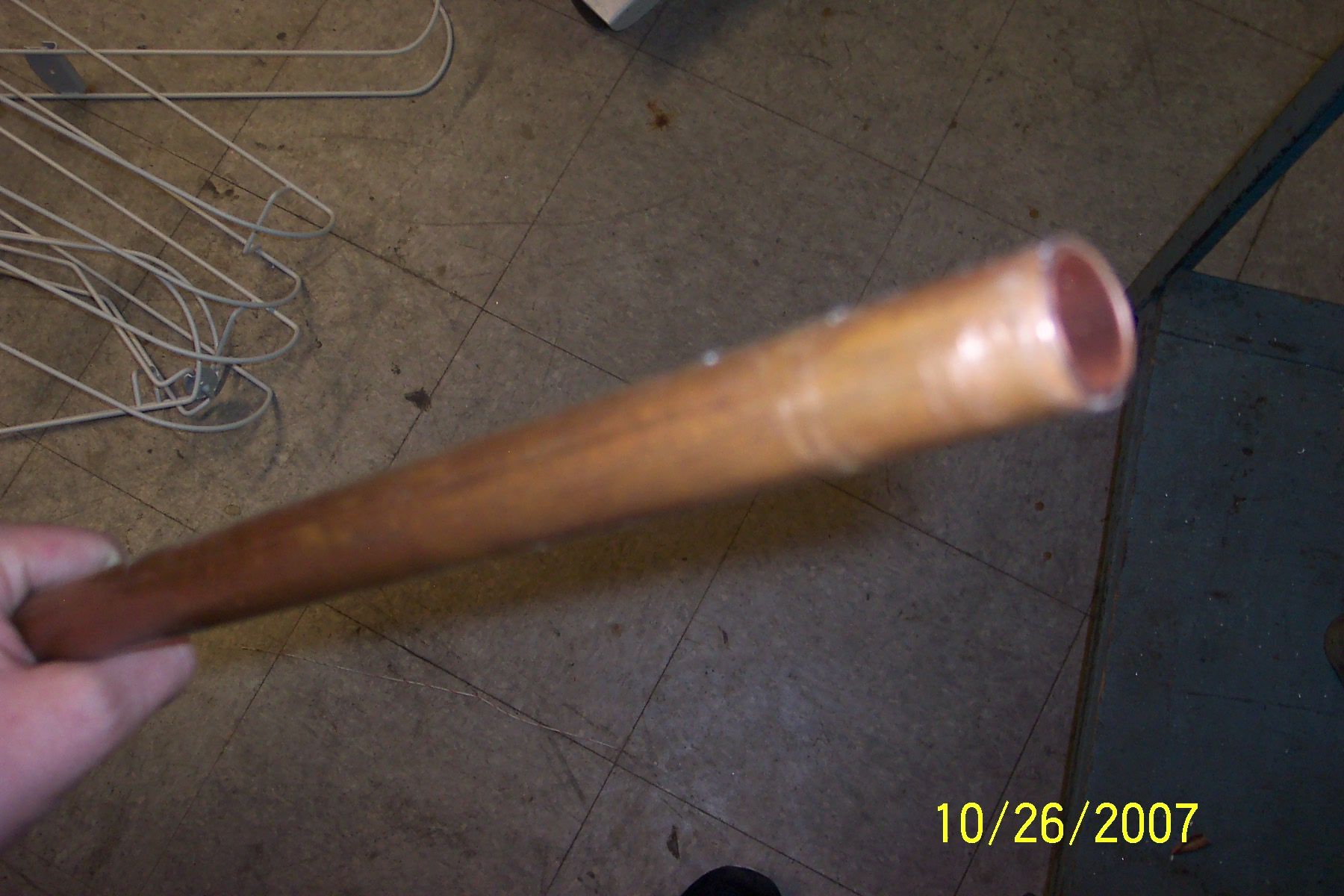

For those looking for a cheap AND simple solution, try this idea:
(which, now I’ve read the full thread carefully is what Hakucho recommended. Must be a spate of headset removals going on … :wink:
Took me about 5 mins to hacksaw and about $6 worth of copper tubing. Mind you, its not pretty - I wished I had my metal band saw out from storage. Still…
Worked like a dream! Knocked the cups from 4 frames for painting in under a minute! It was a bit of an anti climax in the end after all the horror stories I’ve been given.

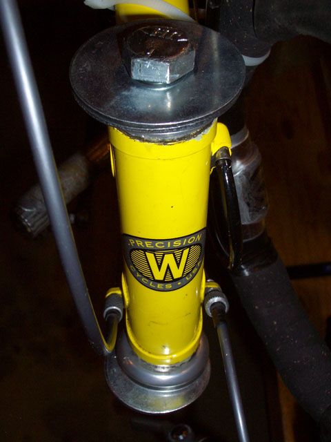

Putting them back? I got some 3/4in threaded rod and built one of these:
All up, about $30 in parts from Bunnings - the most expensive being the copper tube - I had to buy more than I needed :frowning:
