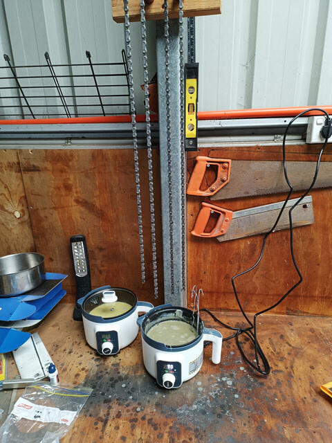

I have my wax pots setup on the workbench in the shed. Not worried about mess or SWMBO that way.
I spent a bit of time on zero friction cycling as he has done testing that reveals just how much better wax is compared to drip lubes. Squirt hot wax is temperature sensitive. Keep it below 95c. I emailed Adam from ZFC for wax pot suggestions. He replied with a link for a pot from Amazon which he hadn’t used but looked good. About $80- can set and forget rather than watch the temp. Happy with it and have 2 now. One for road and one for gravel.
