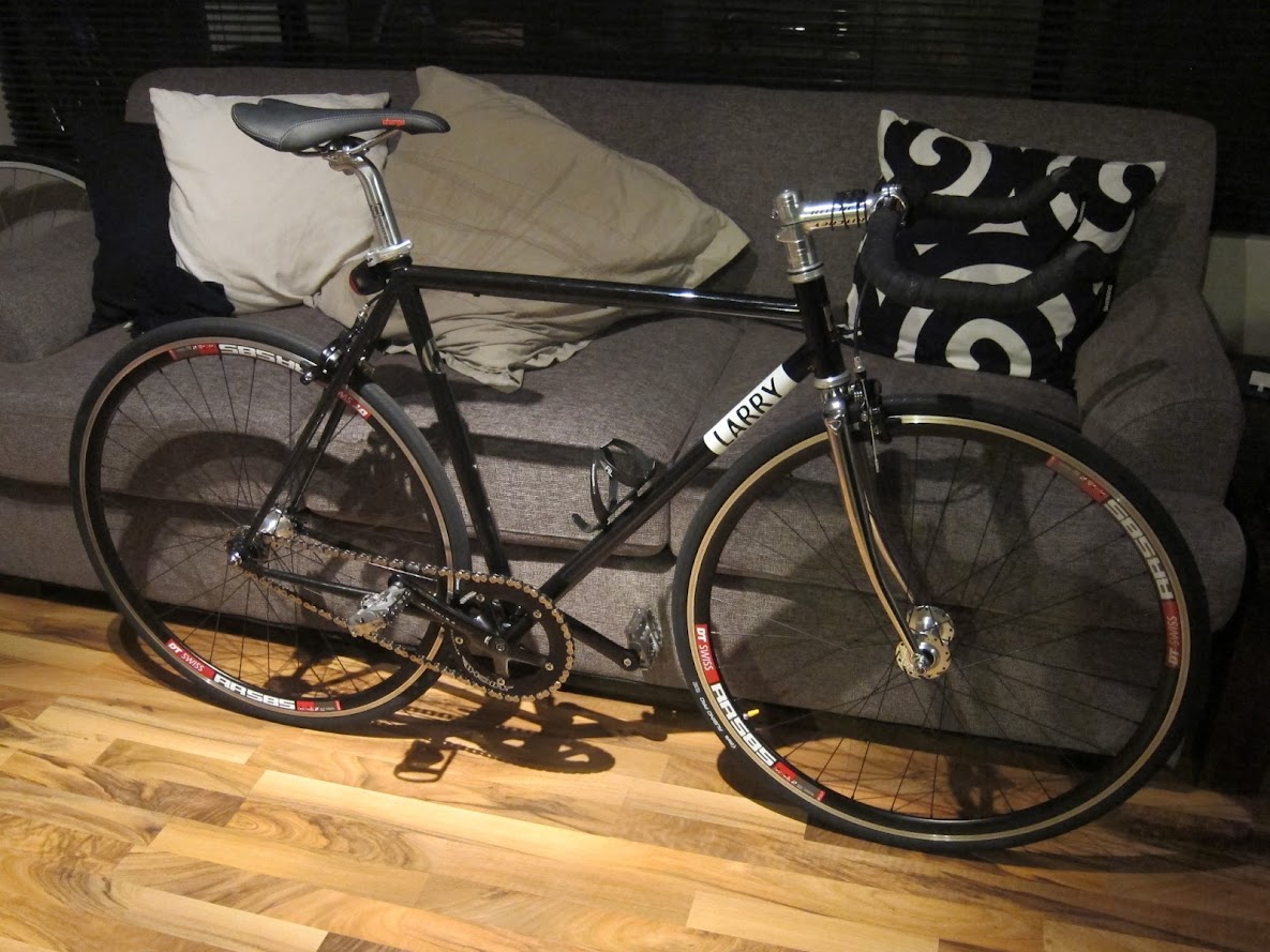

My Setup:
I may ditch the TT brake levers and go a front only in the near future but for now having front and back braking is helping me ease into riding fixed.
