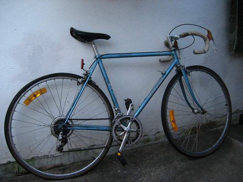

hey Anyone know anything about Centurion Bikes?
Found a discarded full bike down the road from my house.
- Centurion: Tange Tubing (couldn’t see what sort though)
- DiaCompe Brakes
- Sugino GS Crankset
- and i think Suntour Derailer.

centurions used to run the whole spectrum of quality. at the top was their dave scott ironman expert was v nice, tange 1, 600, nitto bits and pieces.
it’ll be interesting to see what type of tubing it is. whatever it is, i think its a rad brand and i’d make a pub bike out of it for sure.
what JP said.
Some Centurions are very nice.

yeah I’m Intending to strip it and Fix gear it.
it looks pretty rough so will probably pull it apart completely. Will take a better look tonight and upload some photos.
I did find a bit of info on them here though:
I assume they would be 27" wheels? yeah?
Centurion Turbo.
Tange Industries Champion #5 tubing,
Sugino Cranks,
Suntour derailers.
Araya 27x1" rims
DiaCompe sidepull brakes

all the bits that you’ll keep from that bike look good (cranks, bar, stem, post, seat, wheels).
if you like, take the wheels to a good mechanic and get the rear axle flipped in the hub, screw off the cluster, dish the wheel and BAM! you got yourself a possibly straight chainline, probably sealed hubs, and not much spent. i like the paint colour.

yeah they look ok mostly.
Why do i need to get the rear Axle flipped in the hub? I don’t really get that bit.
Stwike him Centuwion, vewy woughly!
Because you’ll have the spacers on opposite side then. Take the bits i.e. cone, washers… from one side off, clean re grease everything and flip to the other side. Then redish (see god) and as JP said “…BAM! you got yourself a possibly straight chainline…” on the cheap, just like the budget.
