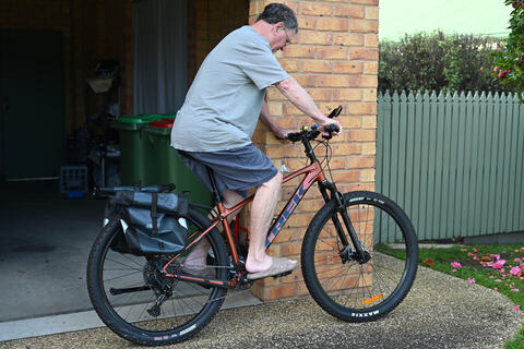

Me on Vivente…sorry about the angle, wife was taking photo, I was having to lean on brick wall
Told you I was old & Decrepit :grin:

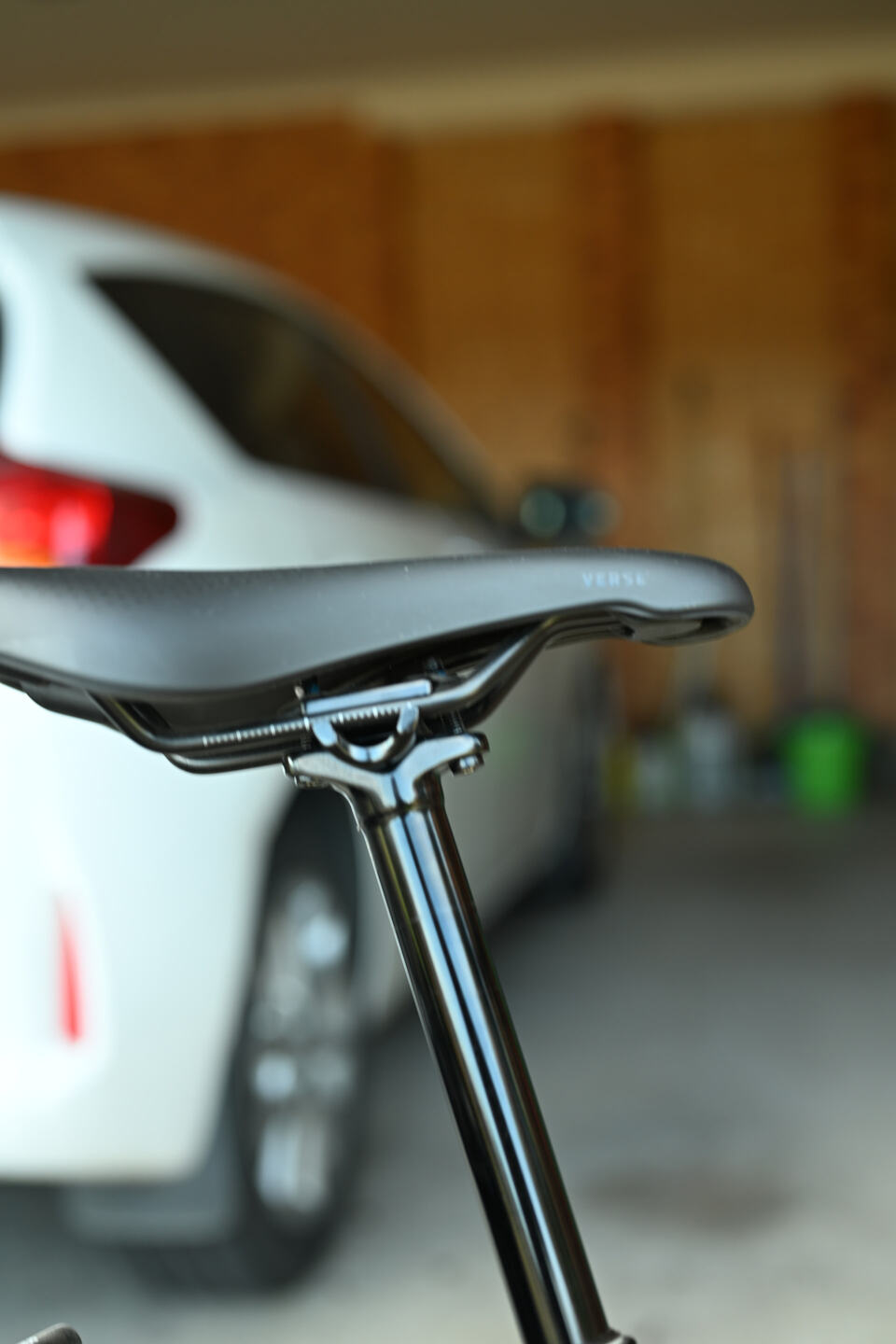

This is saddle and post from Trek MTB (they were loaded not in sequence.)

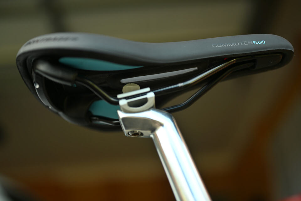

Below is the saddle and post from the Vivente
Me on Trek MTB
This seems to be a better sized bike overall although the handlebars were too low for me until I added an extension stem

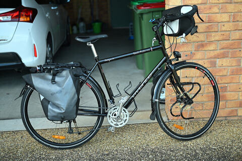

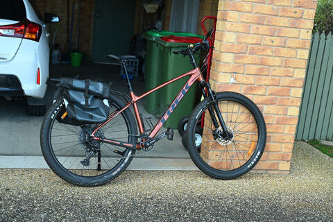

Trek Marlin 7 MTB
The Vivente WR Patagonia (Below)
I don’t think you need a new frame going off those photos. You still have the ability to shorten the stem further on the Vivente if you need. Looks ok to me.
My type of fit/riding is much different to yours, but I don’t see a frame that is totally the wrong size.
The trek post is a zero offset post and you have the saddle right forward on the Vivente offset post. If the are the same diameter you could try the Trek post in the Vivente. A zero offset post looks like it is what you need on there.
On second thoughts it may be a dropper post on the Trek? I know nothing about them but would prob be a pita to swap out.
Yeah Warty, it’s a dropper post mate fitted to a cable so I don’t want to upset that system but maybe if I could find a zero offset post to try it out…it could be just what is called for…I think the rest of the bike could be made to adapt me better if I just change a few things…
It’s in such good condition, there’s not too many of the traditional touring bike set-ups like the Vivente around these days, possibly the Kona Sutra might be the only bike left with the bar end shifters and they are not the Shimano Dura-ace like the ones one mine, I think are the Micro-shift ones are the only brand left.
I had the handlebars turned up towards me more with the hoods closer to me but then I had to reach a long way to change gears :grin:
Yeah I would also say that looking at you on the Vivente, it doesn’t appear too large.

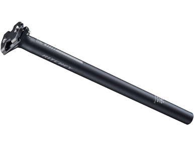

I reckon that quickest thing to try would be to install a zero-offset seatpost.
The zero-offset seatposts do cost a bit more than the traditional style ones.
I had a quick look on Pushys website and here is a good quality one :
There are some cheaper zero-offset posts on their inventory but the cheaper ones are either in the 30+ mm diameter (I assume that your Vivente is a 27.2 diameter), or are out of stock !
