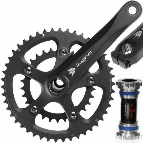

Get these:
Sugino OX601D Road Bike Crankset For Shimano 9 10s 172.5mm 46-30

Thanks for all the replies.
For the record, I don’t have a problem with the Q-factor on my SLX cranks but I will openly admit that the Dura-Ace 7800 cranks on my road bike do ‘feel nicer’.
The frame I like is this one
TCX SLR Frameset (2014) - Bikes | Giant Bicycles | Australia
I have a set of Stan’s Crest / Hope Pro 2 wheels which I would like to keep using on my gravel bike.
I’m not going to lie, lots of this is fuelled by aesthetics and the satisfaction of having a bike that I love riding and so while I can see why people would recommend something like the Surly cross-check, it’s just not for me. That’s all down to personal taste though - I’m sure they’re great bikes.
If I can use an adaptor and use my SLX cranks then that would be fine with me.
