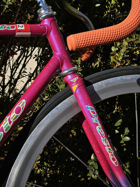

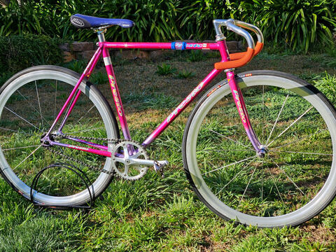

Second daughter continues to grow (9yo, 150cm) and is now getting into the common NJS sized bikes… this will not last so we pulled the trigger. We had a lot of fun pouring over NJS export for a couple of weeks and she is really happy with how this came out :slight_smile: Will hopefully see her through the next couple of years til u15.
Specs:
Presto NJS frame and fork, about 52 square. Honjo doesn’t generally tell which tubing is used.
Superbe Pro 165s on Hatta 9400, shimano touring style SPDs
Nitto AA b125 and 60mm technomic (a 90mm pearl is waiting for growth to happen). Swan HS, Strong grips.
Nitto S92 and blue Flite Ti.
Gipiemme 716 pro (i think?) 16sp on Miche hubs, tied at the rear. Challenge elite light 23mm.

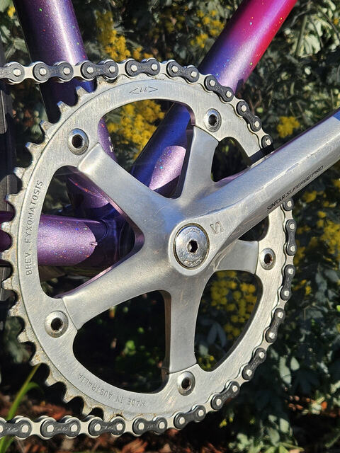

44t Fyomatosis ring (!!!) and 17t velobike (U13 rollout), Izumi Jet.

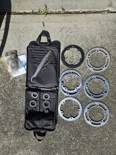

how are you for rings/sprockets for the fleet?
I have a (Gippsland made!) track bag filled with rings / sprockets languishing in the garage. Mix of NJS and Cycle Underground (the maker of the fyxo ring)

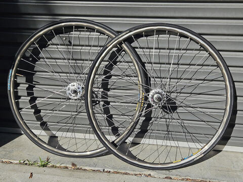

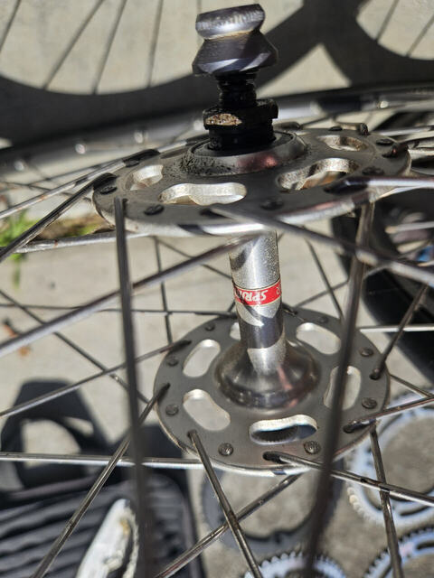

Heck there’s even a set of SunTour Sprint to Mavic clinchers
Super interested in it all :slight_smile:
will dig out and photograph
Chainrings:
Sugino Mighty Comp 51
Suntour Superbe NJS 50
SR royal LA-5 49
Cycle Underground 48
Cycle Underground & Sugino 75 NJS 47
Cycle Underground 46
Sprockets
DA NJS 16, 15, 14, & lockring x2
Soma 15
EAI 13
DA chain whip.
Suntour Sprint to Mavic Open4 CD 36H, straight gauge hoshi. track nuts rear, allen qr front
track bag has slots for rings, spanner etc and pockets for allen keys, sprockets, lockrings. full depth pocket behind ring pouches for chain whip etc
