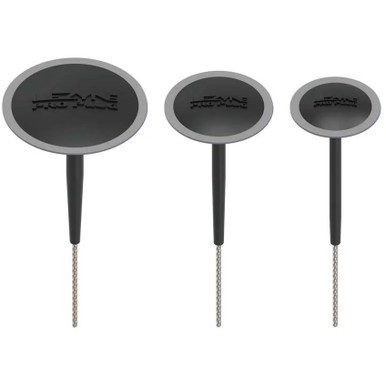

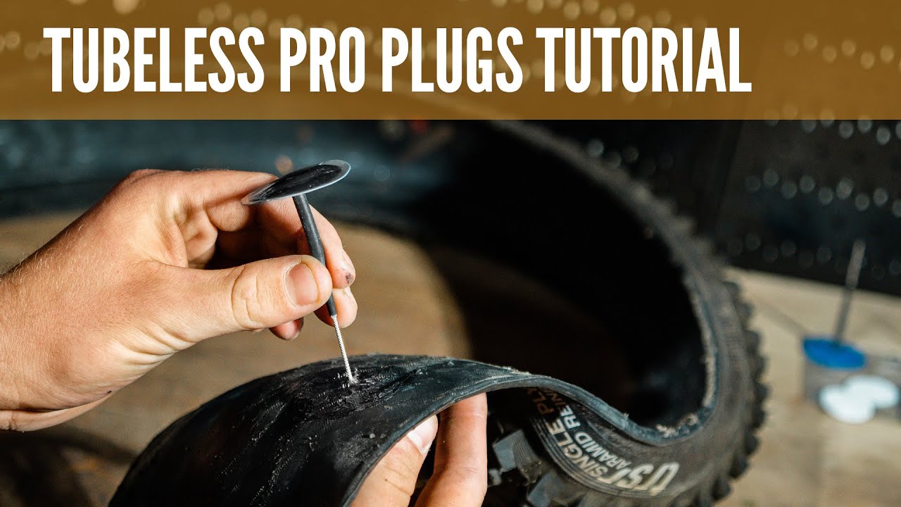

I have recently Lezyne Tubeless Pro Plugs for repair of tubeless tyres where they have failed to seal after using dynaplugs or similar
Interested if any have used these with success

I have been using tubeless road tyres for some 20,000 km and rarely have punctures not sealed but on two occasions cuts around the join between sidewall and tread required the use of a plug in my case dynaplugs.
These didn’t seal immediately but left overnight with low pressure 10psi seal was effective.
In these marginal situations I thought the Lezyne Pro Plugs might be an answer rather than binning the tyre. They use a different technique in that they plug from inside the tyre.

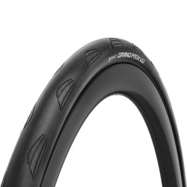

Running 30mm Conti GP TR on the front and 32mm Michelin pro5 TR on the rear at the moment.
Conti from AliEx and Michy from BikeInn. Happy with them. :ok_hand:

I have been getting a good run from Pirelli Cinturato EVO TLR - 32 front and rear.
$100 from Pushys … not that keen on O/S sourcing as getting 12 months or a bit less out of a set so not a huge annual saving
They haven’t all been tested in a 32. Here they are in a 28;
Those Pirelli are a very slow tyre and I am getting mine at ~ half that price. Just need to buy a few tyres at a time from bikeinn due to the postage. I buy tyres for the gravel bike also at the same time.
Those Pirelli are thick and heavy though so will probably outlast the other two. Depends on what you are after I guess
