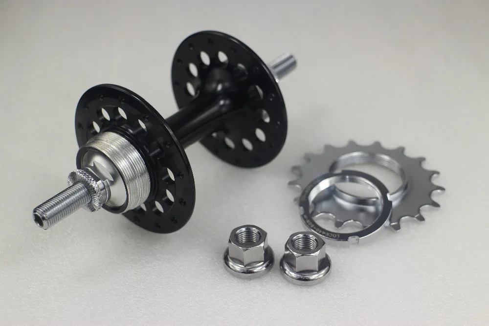

Does the rear hub/wheel take a fixed cog - ie, threading for a fixed cog and lockring? If so, good:
If you don’t have these let us know what you have. We might also need to know what the rear spacing is on your frame. Most fixed wheelsets fit 120mm spacing, but if your current wheels are 26" and not 700c it’s more likely your frame has 135mm rear spacing. In that case you will need a wheelset that is 26", 135mm spaced and with a fixed threaded hub. Might be hard to find.
Can you take a close up photo of the rear hub?
^ Sure.

You will probably need a new rear hub (or wheel) because your one doesn’t look like it will take a fixed cog.
Because your wheels are 26" (and I also assume 135mm spaced) that makes it difficult. Not many 26" wheels available with a fixed hub. Probably you’ll have to get someone to build you the wheel with a 135mm fixed rear hub, and that will probably cost a bit.
In the end, with this bike, the cost and annoyance might not be worth it. If you really want to go fixed you might be better off getting a cheap fixie, which you could probably get for the price of building a 26" fixed wheel.
what diddy said.
buy a cheap fixie from somewhere (Cell bikes perhaps) and keep your current bike for when you wanna put fat tyres and canti brakes on it and ride it around in the mud (or just to the pub).
