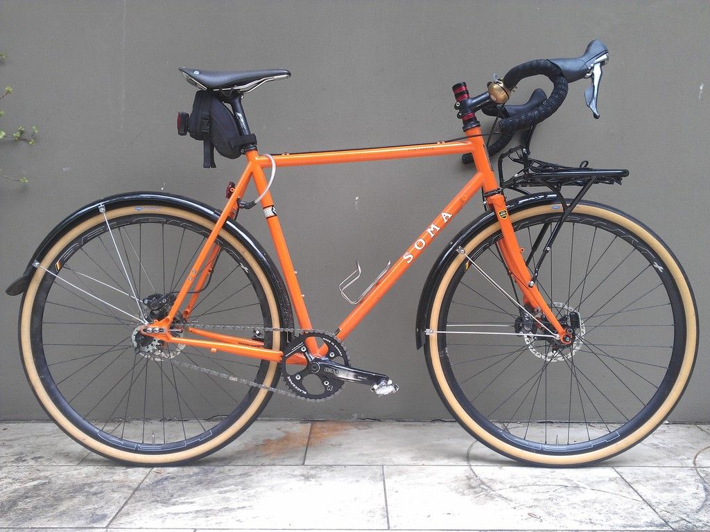

Changed the gearing to 44:18 = ~67 gear inches, with a Blackburn DH chainring, Surly 18T cog and a Shimano HG-40 chain. Last week I had dropped the stem down another 10mm, still mucking around with cockpit setup, but don’t think I can go much lower than this.

Barlow Pass 38’s, IIRC it’s the heavier version of the two types available that Spirito had on hand when I dropped him a line. Comfy as it gets, only one flat in 1300kms, a double from a thorn and piece of metal at the same time. Looking for something with more puncture resistance, but weight becomes an issue. Would like some of the new 40mm Maxxis Re-Fuse.

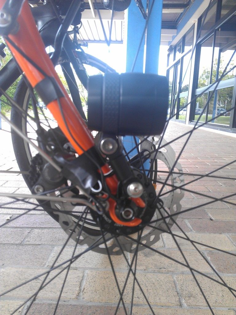

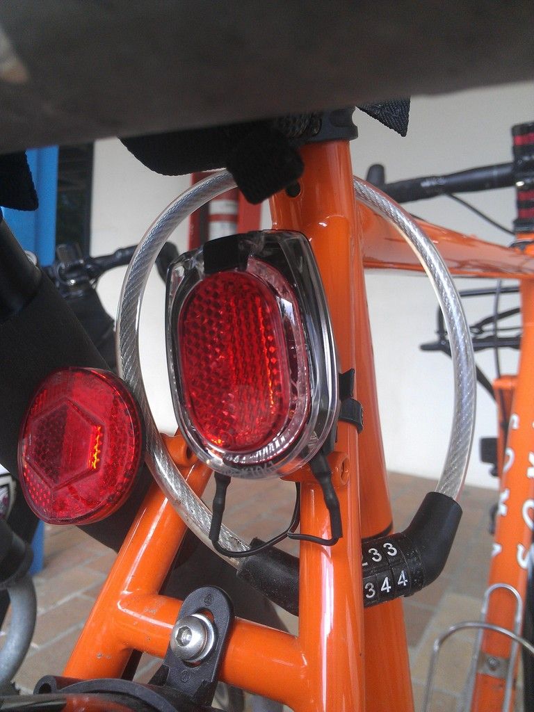

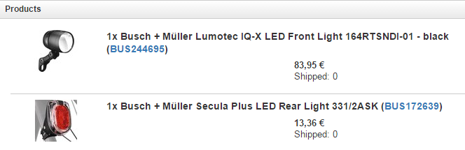

So the B&M IQ-X finally turned up and the Secula Plus came with it. I installed them on the weekend.
Bit of spare cable at the moment.
Weird that the rear lights wiring isn’t next to each other.
They work great. The IQ-X puts out a shed load of light and the Secula Plus lights up red all around the light, including the clear plastic bit of the lens.
The mechanical engineering guys at work are nutting out a bracket for the IQ-X to be mounted on the front of the Globe Porteur rack. A P-clamp would work, but I’ll see what they come up with, they wanted a challenge. I do like this welded on one for the front of a Tubus Tara rack, but it sounds like they’ll be working on something that will clamp on that I can then bolt the light straight to.
I need to now thread the single strand co-ax cable I have through the fork and drop Blakey a line about those connectors he said he had to allow me to disconnect the lights when needed.
Plan is also to get the Secula Plus Mudguard light in the future when I get some new guards (SKS Bluemels in black and 65mm width) to replace the current ones which I’m now pretty sure are for a Townie Electra 26 with Fat Frank 3" tires. The current rear light is fine, but I now see why Blakey says not to get it, it’s a pretty shitty mount onto the bike, just using half a round curved bit of plastic and a zip tie.

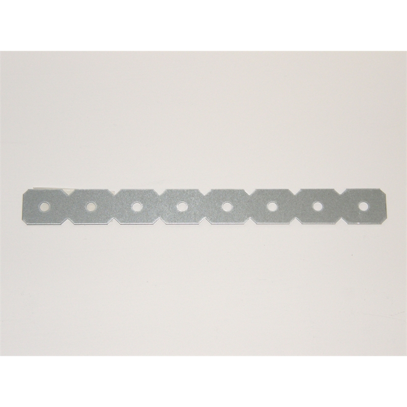

I made a brake bridge mount for secula mudguard using a bit of this.
3 squares worth top hole for main secula screw, bottom hole on brake hole, middle hole acts as a strain relief and an additional hole for the secula anti-rotation knob. Hacksaw and file to ensure it doesn’t extend beyond bridge.
