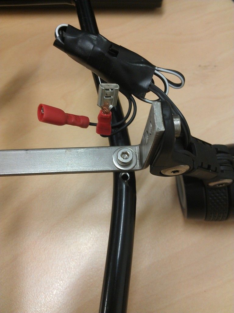

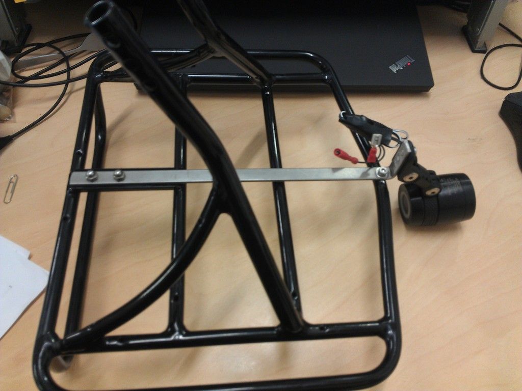

Ok, guys at work just dropped this back on my desk.

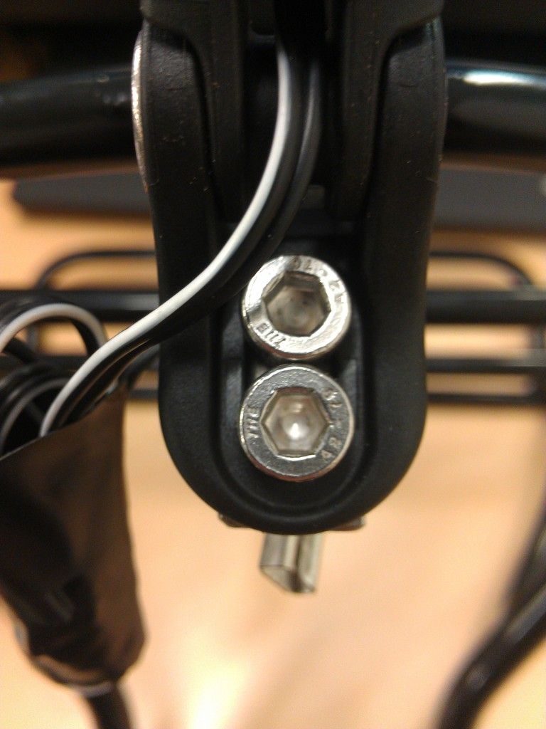

How it looks at the head tube end, will undo the bolts (possibly replace with slightly longer ones) and slide the existing tang off the fork crown mount in and then do back up.
How it looks at the front end, note they used the existing weld hole and tapped it but found it was off centre, so drilled and tapped a new hole in the centre to suit.
And the standard B&M mount is double bolted to the new mount.

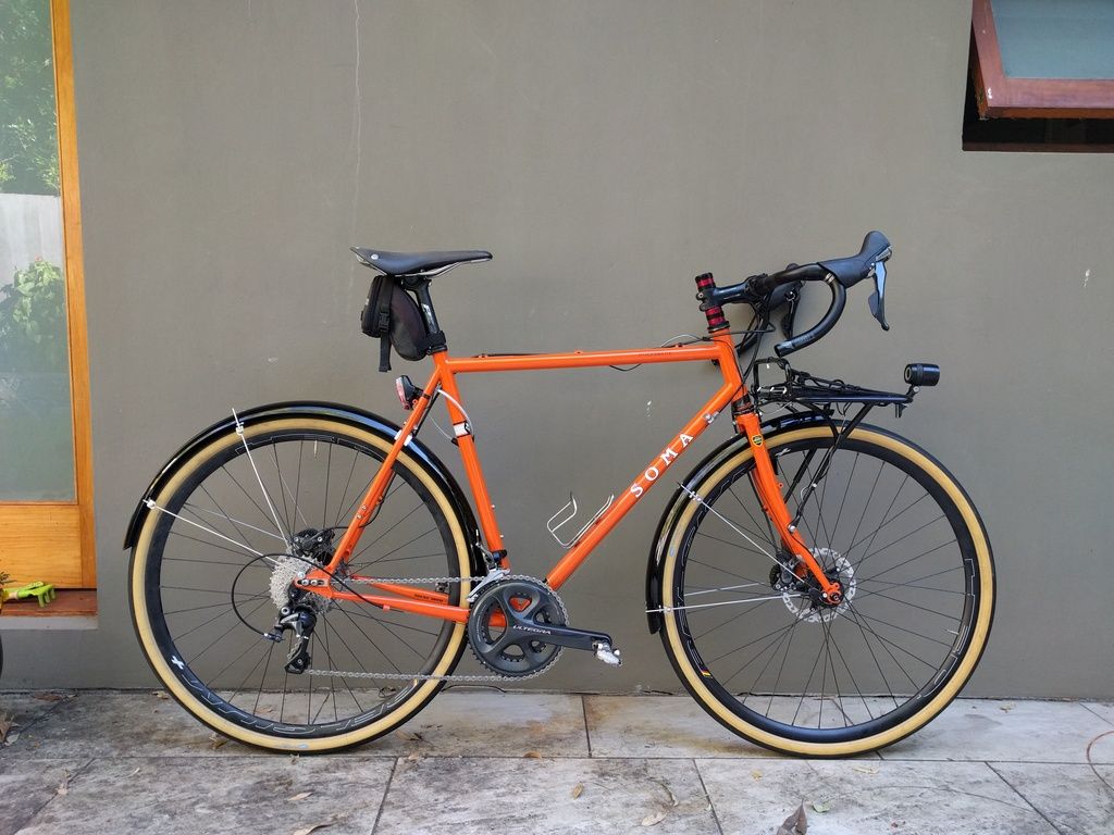

And now updated.
Have added Ultegra 6800 compact 50-34 cranks and 11-32 cassette, front and rear derailleur, chain and a new BR-RS685 Brifter. Also swapped out the 60mm guards for some 65mm Bluemels. It gained me an extra 50mm length in coverage at the front and 100mm at the back. as well as theoretically being able to fit some bigger tires.
Weirdly Bluemels don’t make allowances in a cut out for a front derailleur like my previous ones did, so will have to get the dremel out and fix that up. It’s very snug at the BB area as well, with a bit of bending going on. The metal bracket for the top of the seat stays is also a bit naff, no matter which direction you put it on it will rub the seat stays, will have to do some persuading on it.

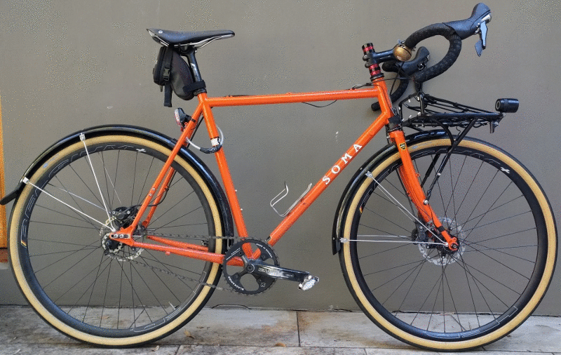

Got funky and created a gif of the changes.
Very nice!
Yep, rad. Hey if ya wanna flip them tyres for bigger ones I know Brad is after some for the #condamineovanighta
Ha sweet, i was just scrolling up and down trying to pick the difference until i saw this.
Put the downtime watching Roubaix to use and compiled an animated gif of all the phases so far for the build.
