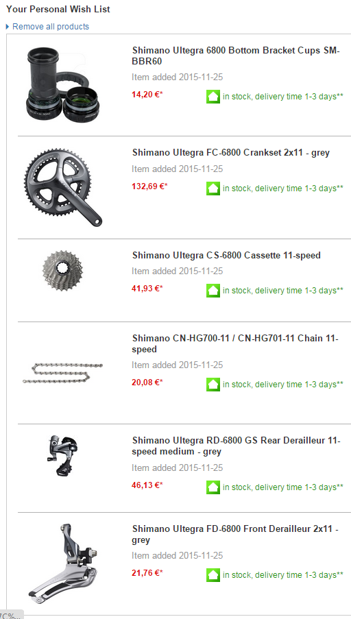

Looking at Stage 3 which is adding gears to the Wolverine. My current wishlist at Bike24 looks like this.

What crank and cassette ratios are you going for?
50-34 compact, 175mm long.
11-32 cassette, I have hills all around me and a kid in a trailer to tow.

Anyways, guessing the above wishlist is all good? No issues? No upgrades/replacements I should be looking at?

I don’t have experience with the BB, but the rest is all fine
Not that I can see
