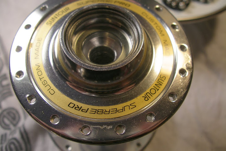

My dad raced on them years ago, but when I was a kid he laced them into some 20" inch track wheels for me to ride as a junior. He’d built me an awesome little aero tubing track frame, which I grew out of in a year or two… All I wanted at the time was a bmx. (insert facepalm). The wheels then kicked around in his shed/the garden for the last 10 years, til I dug them out of a pile of rusty junk.

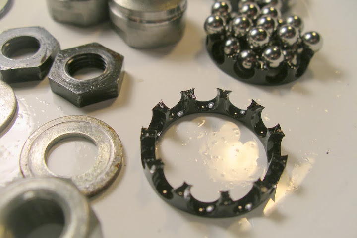

Here’s some pics. In response to that guy’s thread about the differing types of Superbe Pro hubs, I can answer that the NJS stamped ones do indeed use the modified 6001 bearings, which makes them borderline-cheating as far as the NJS cup-and-cone rule goes. Nice work Suntour, tricky old dudes.
the reason they spin so well is that they’re actually cartridge bearings with the plastic ball retainer chopped down (fairly crudely) so that an adjustable cone can take the place of the inner race.
the bearing ‘cup’ is actually a pressed-in cartridge bearing race, so it’s removable if you have the right bearing puller.

because the 6001 cartridge has been pulled to pieces, it’s quite fragile - the inner ‘seal’ is just a very flimsy piece of metal that’s pressed in, and you need to draw it and the bearing race out carefully and squarely to not damage anything. you’d need a bearing puller of the right size and shape - could be made at home with the right nuts, bolts and washers i guess.
that’s it i think. hey presto, pretty looking old hubs with sealed bearings for the street.
